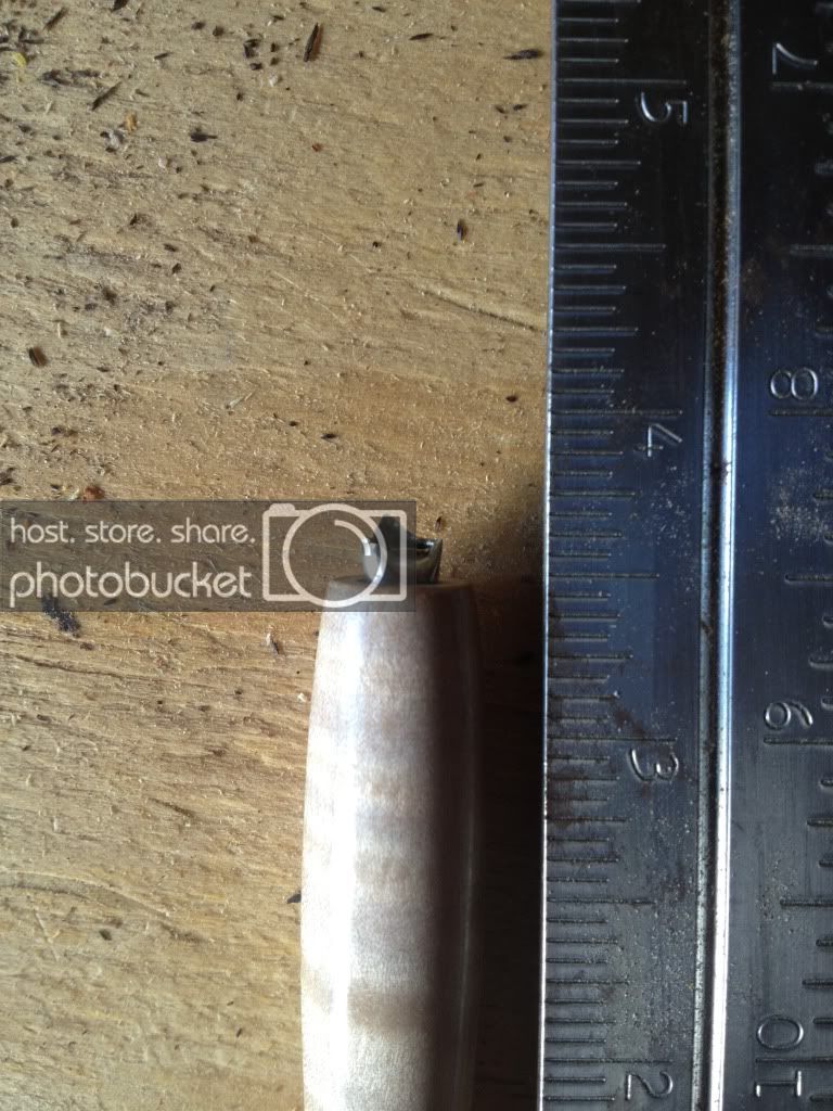

Ran into a problem I am hoping a seasoned pro on here can help me out. How do I save this pen:
Have you tried using the correct sized punch and taping it out from the other end of the blank? If you can you can then replace the damaged part with a new one. From your photo it appears to be a transmission.

At this stage you have pressed the pen tip so use a 1/8th rod to tap out the tip then a 1/4 inch smooth fit from the tip end long puch a voila start again I must say I trial fit a biro in every twist mechanism to ensure no faulty twist movement or faulty biro thread saved me many times, this problem easily solved I bought a refill set of rods used in a paint remover device that uses a lot of them in a compressed air unit sold at places like specialist tools.

Michael, then usual disassemble sequence is to knock the tip end out with a punch inserted through through the tranny. However, that looks problematic with yours.
If it were mine I would probably try to drill a clear access hole through the old tranny to clear that ragged scrap out of the way.

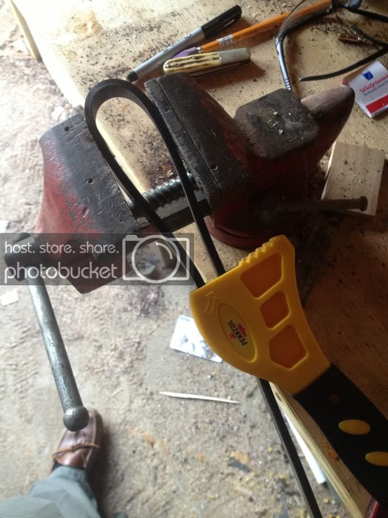

Thanks to all of you for your help. This is what i did:
Used a old rubber wrench and a vice to hold the pen, used a couple of punches i got at the local Ace and = HAPPY HAPPY HAPPY:

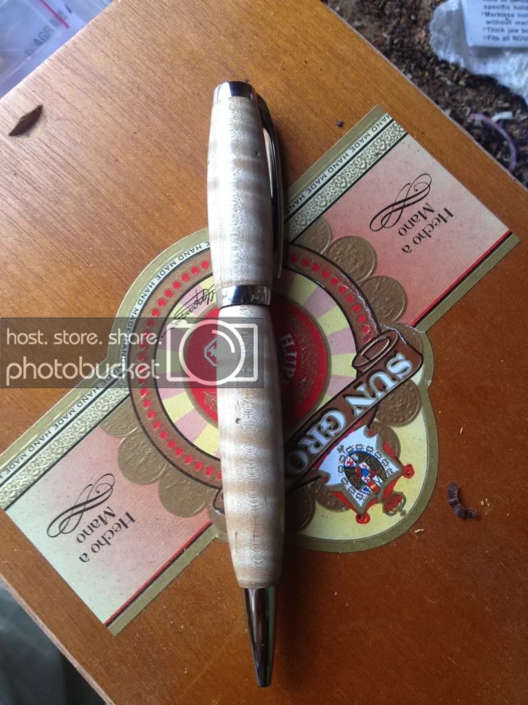

Final product: Curly Maple
Thanks again.
The vise-grip type "pen pliers" they have at Woodcraft and a set of Harbor Freight transfer punches have saved my bacon too many times to count. I like the method you used as a work-around, though!
