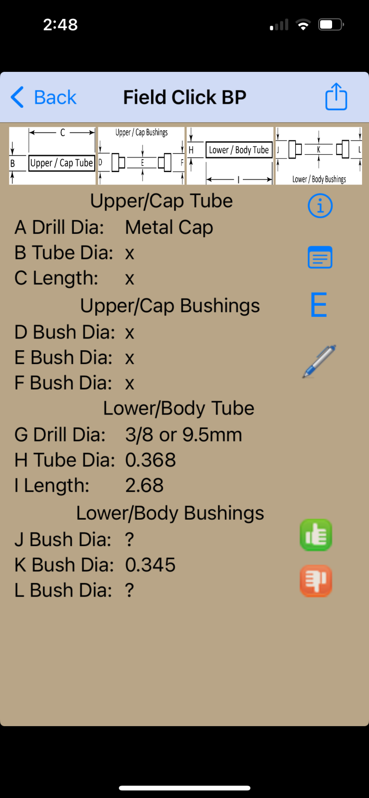

aNYONE HAVE THE SPECS FOR THE tURNERS WAREHOUSE fIELD CLICK PEN Some of my bushings and tubes got mixed up when I had my stroke. Trying to get things back in order. Need tube and length and bushing specs
Check out the IAP bushings and tubes app if you don't have it. Here is the info from the app.
It is apparent that TURNERS WAREHOUSE does NOT want you to know any of the specs of bushings and tube length. Guess I will have to shop some place else.
Get yourself some calipers, you can accurately measure the diameter where the body contacts the nib and the click assembly, giving you the outer diameter of the bushings. Tube 3/8, which gives you the smaller diameter of the bushings.
Per Turner's Warehouse site, "the tube is approximately 68mm". And elsewhere, "there are currently no instructions for this kit"...
