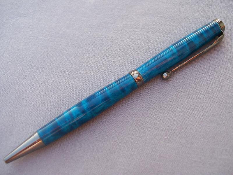

Brain (USAFVET98) made one very similar to this. He was kind enough to share his "method of dying" the wood. :wink: So I thought I'd give it a go.
It's Curly Maple on Gun Metal dyed blue, and I'm really starting to like slimlines.
Comments and Critiques welcome!

Zack,
If I can ask, what method did you use to dye the wood? It looks more vivid than what I have been able to do.
Thanks
Kevin
It's a very long and involved process as mentioned.... not really, just some food coloring on a paper towel. One pass and done (and a little touch up). The food coloring I used was "Neon" if that matters. It's all my wife had in the house.
Awesome job and the finish is beautiful. I dread the time consumption of this method, but it turns out great! LOL. It looks really nice with quilted maple too. I am going to try some spalted woods when I get some time..
