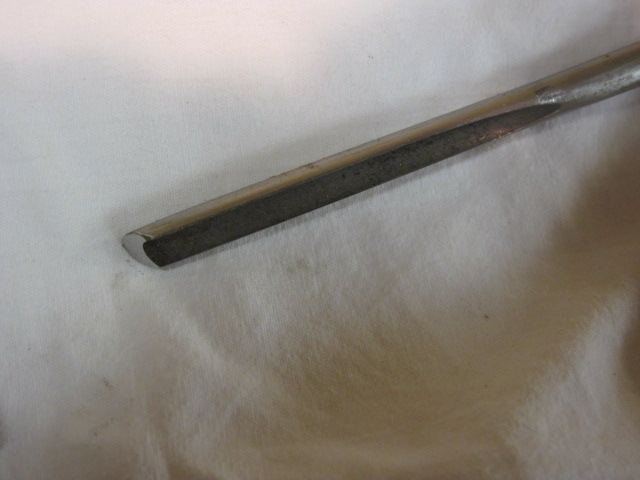

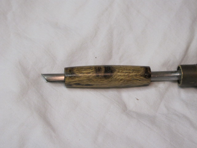

I read several threads on this site about people having problems removing all the glue from the inside of the pen tubes without removing brass and creating out of round tubes resulting in poorly fitting pen parts to tubes. You can take an inexpensive 1/4 inch gouge either bowl or spindle configuration and grind a opposite than typical 45 Degree grind which will create a bur that will remove glue without damaging the brass. I always use a Qtip to apply a release paste wax or lubricant prior to glue up. I use a tube insertion tool . After the glue is dry i use a mini chop saw to remove 1/16 inch of glue and wood off each end and use a hand countersink to smooth up the ends.Then remove any glue inside of the tube by inserting the tool mostly through the tube to push/ scrape the glue buildup from the outlet end . I had to sand my inside tube scraper slightly to fit through a 7 mm tube, now i can use it on any size tube. It actually performs its operation on fatter tubes with greater ease than on the 7 MM small ones.
