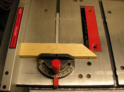

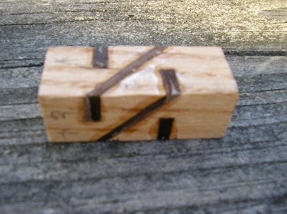

Here is my attempt at the post from Richard on the inlay. It took me quite a while to figure out exactly what he was talking about. IF, I figured it out. And he may have another way in which he did it. So thanks to Richard.
I have 4 pics to share with you. So i'll split them up in a couple of posts.
Here is the wood blank after cutting and doing the inlay.
The next pic is of the board I cut the angle in. This happened to be at 45 degrees. By changing the angle it will spread the pattern out or bring it closer together.
