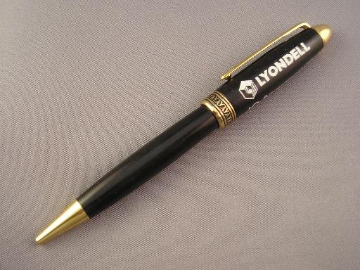

Here is a pen I did in Ebony with a white epoxy inlay.
