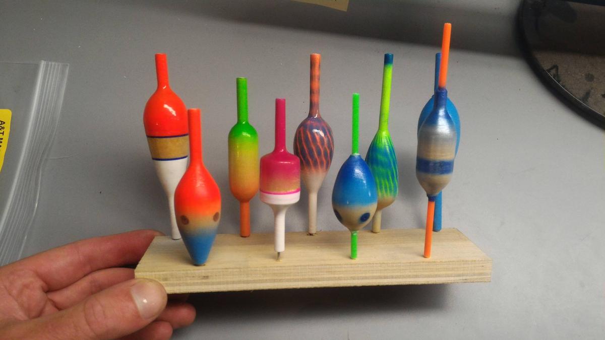

If I'm brushing (while turning on the lathe) I like the coverage that enamels provide, but I've been dabbling with the airbrush (very new to that) and stick mostly to acrylics for the easy cleanup w/o acetone or other nasty chemicals. I've got about a dozen finished bobbers sitting here on the bench, maybe I'll toss a pic up in the "other stuff" forum sometime soon.
You need to be careful with either one, as both will run if you rub them while applying the CA on the lathe. I turn the lathe down as slow as it will go (about 500 rpm) and quickly and carefully apply a medium/thick CA using light pressure. Too much pressure and you'll rub out the paint, but if I'm careful with the first layer, it's all downhill from there.

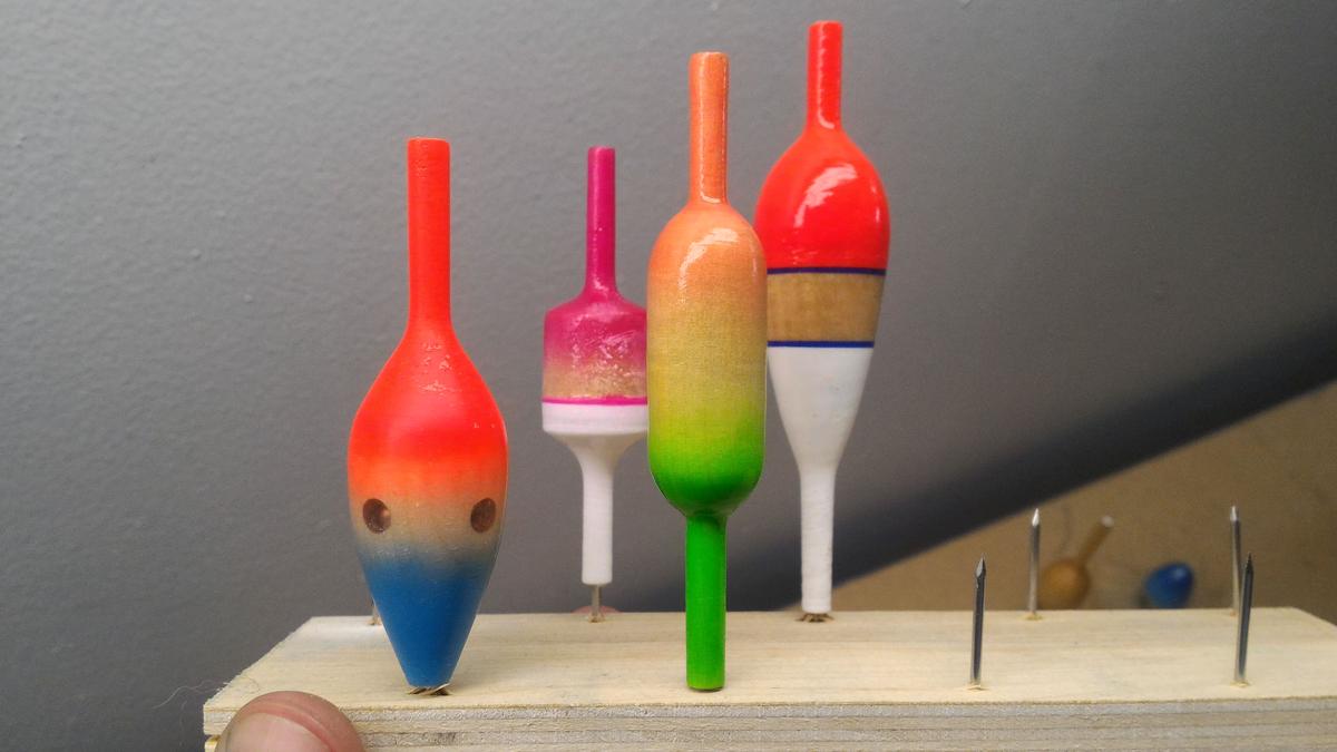

The thought of color spooking fish has certainly crossed my mind, but never finish. Most bobbers that you'd buy are white on the bottom, as the fish will be looking up into the light of day. You don't want a big dark shadow to spook them. Most of the bobbers I turn are either white or natural wood on the underside for this reason. I have also made a few that are other colors, mostly because I'm trying to teach myself to airbrush, and it's fun to play with bright colors. I think green is another good color, as it looks like a piece of leaf litter etc.
Personally, I don't think that a matte vs gloss finish would be much of a deterrent for a fish, certainly not as much so as a day glow orange! If you're fishing very close to the surface (super short leader between your bobber and bait), in extremely clear water, or around exceptionally spooky fish, I could see this being something to think about. However, I'd assume that the big floating *thing* would be much scarier than a light flash off the surface. Remember, fish see flashes from the surface all day every day, from even the slightest ripple in the water. I prefer the gloss finish for 2 reasons. One, when you've got a bobber waaaaay out there, where you can barely see it, sometimes you'll pick up a slight glimmer from the sun (after you've reached for your beer and lost your bobber's spot), and 2, they look prettier :biggrin:
However, I'm not a terribly "serious" angler (like most of you fly fisherman!). I love to fish, but it's as much about being on the water on a beautiful day with a cold drink as it is fishing. Sooooo... I could be very wrong!
I haven't had time to turn many of these recently, all of my turning time has been spent working on an order for a co-worker. However, I've been playing around with the airbrush a little. Turns out, I'm not very good at it yet :biggrin:
