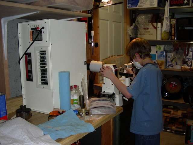

I also get a corner of a corner of (in my case) the laundry room. The key things for me at least were the air cleaner and the dust collector. My Dc is a Fein vacuum cleaner. When I turn (that's not me BTW) Chips fly all over, but the dust is either sucked into the collector or the air cleaner. No complaints so far, and I just use a second shop vac to pick up the chips...
My shop is in the basement, I use a 2hp HF dust collector, the trashcan pre-separator, a triton air shield while turning, and I'm waiting for my Jet AFS-2000 to arrive to help control any latent dust that may try to migrate to other areas of the house. The door to the basement is not air tight as that would interfere with the HVAC system. If I find it necessary, I'll get a smaller air filter system and put it in the stairway leading from the basement to the rest of the house. And I'll soon be replacing the stock bags on my DC with a canister (as budget allows).
