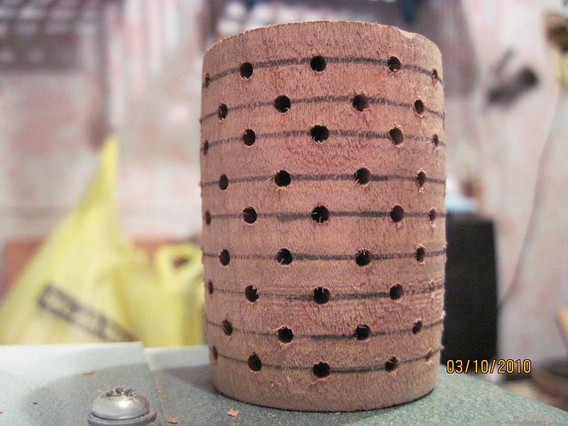

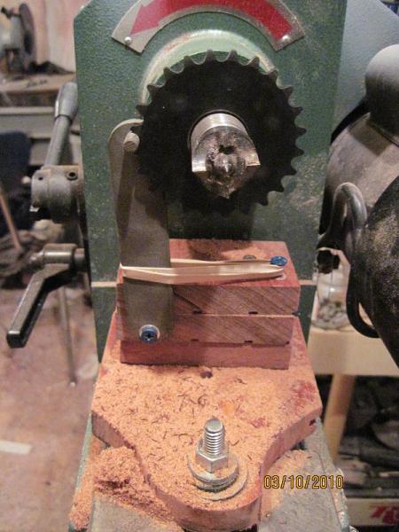

A friend from right here at IAP sent me, in the mail, all the goodies for the ULTIMATE indexing wheel.
This thing has 24 slots of indexing MADNESS! works like a charm... All I had to do was to build the mount for the pin. EASY MONEY!
As for results.... well, for a first try, i am happy!!

The sprocket you see is welded to half of a nut. It was made by a GENIUS right here on our forum! I don't want to say his name because i don't think he wants to make these for a living..... It is engineering perfection. I started to WAY overcomplicate the sled for the pin, but after the original engineer reminded me to K.I.S.S. i came up with what you see. I am working on the dremel table a bit more now. I will post pics if it works out!

I did the sample piece by just loosening the banjo and using my hands. I quickly realized that this method is no good. Now i am working on just a simple freehand slide type table. I am hoping to have at least a little bit more control this way. I have cut a weird shaped table that i will attach to a dowel to put in the tool rest. The dremel will be strapped to the small piece it is strapped to in the pic minus the dowel.

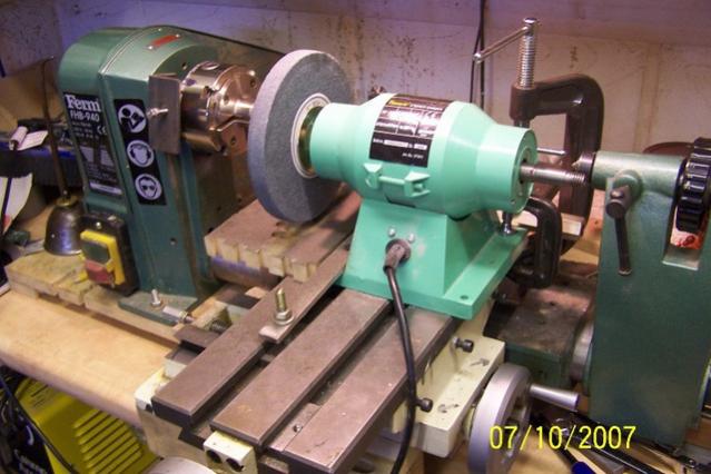

My first stainless pen was made on my wood lathe and I had a bench grinder on the table to make a hex shape on it. I'll see if I can find a pic...
found it..
http://www.penturners.org/photos/index.php?n=4954
NICE PEN!
So let me understand this... you mounted a bench grinder to the compound table thingy from the link to your woodlathe and used it to grind the flats on the pen in the photo?
that is incredible. I gotta get me one of these things for sure!
THOSE ARE SICK!
They look like super fancy handles for a faucet or something. Nw i have something else on my list to use the index on! Thanks for the pics!!!

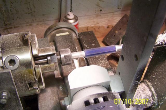

Here are a couple of pics. The first one is with the grinder for the stainless, sorry but it the only pic I had, and the second is a similar setup but with a router to cut the flats on the plastic part. But same pen.
I used the indents around the scroll chuck for the indexing.
