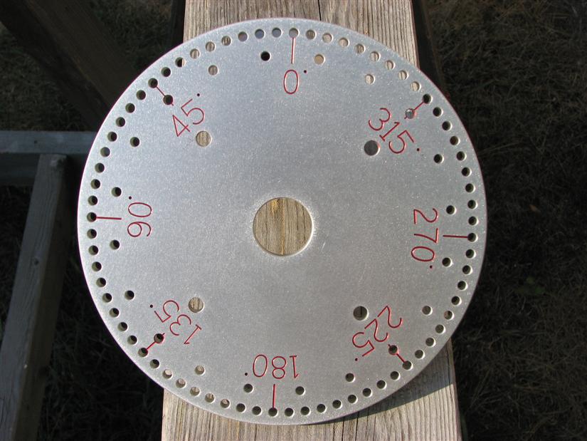

I took a look at existing index jigs,
and decided to make one myself.Yes,I'm frugal.[:p]
I do cnc work at my job and drew this up on Mastercam
at home,transferred the cad file to Unigraphics
at work,tweaked the design and programmed it for
one of our cnc mills.We got a little slack time at
work,and I got it machined today.
It is aluminum,6061 alloy. Ø 7.0" o.d.,72 outer index locations
at 5° spacing.Cut and filled engraving.
Now I have to figure out what I want to do with it!![:0]

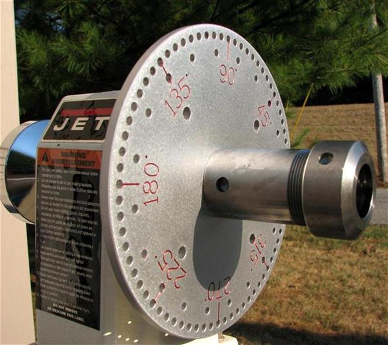

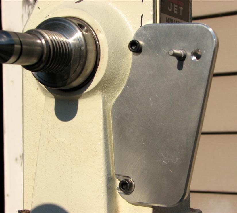

Here is the index pin bracket;
the index wheel;

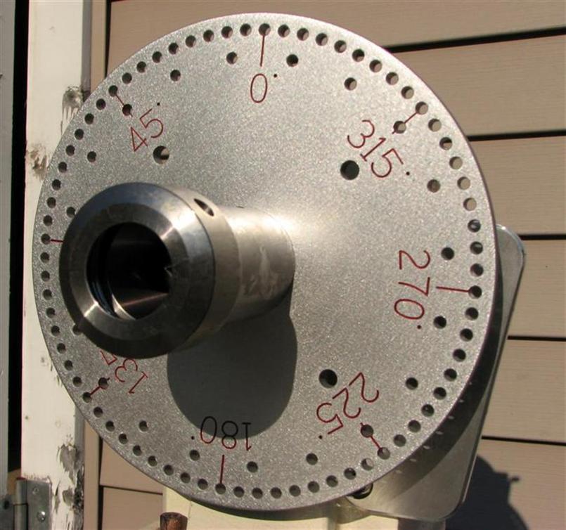

mounted wheel;

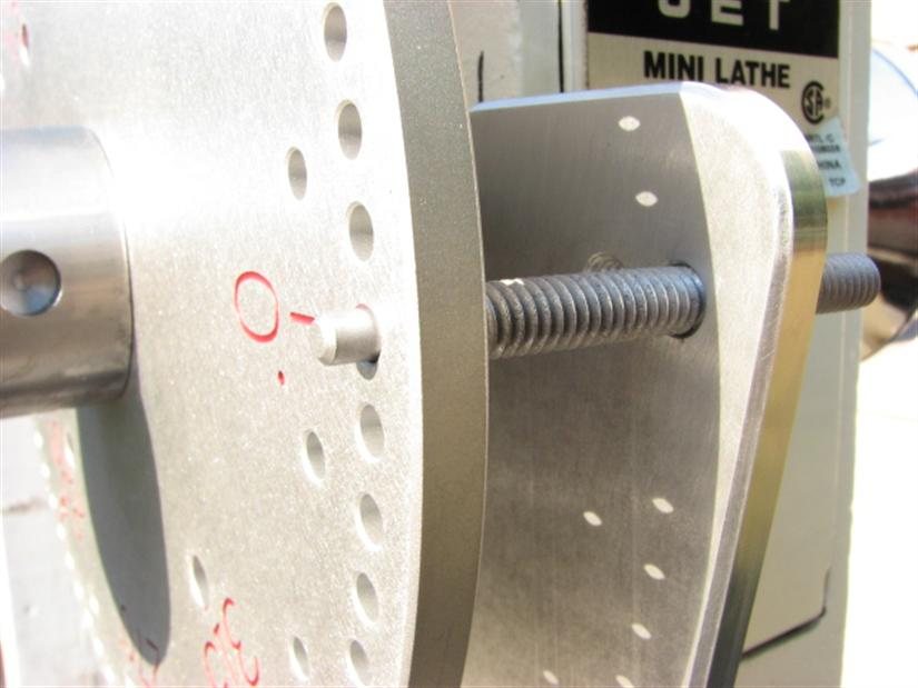

closeup of index pin in place;
And the assembly ready to go;

Greg: I just took a peek at my JET mini and it appears that both of those holes are existing. On mine the lower hole has a Phillips head machine screw in it and is what the return spring of the access door is attached to. My headstock casting has a threaded hole in it about where the upper cap screw is located. On my machine the hole is threaded; but has nothing in it. The parts diagram seems to indicate that there should be a screw in the upper hole, too; but it is missing on mine and I can't imagine what it would be used for in any case??
Johnny: I have a couple of questions for you.
1. Does the index pin interfere with opening the belt access door?
2. What are the four holes at the 90° spacing for? They appear to be a little larger than the other holes and there does not seem to be a way for the index pin to engage them.
3. Why didn't you align a hole in the inner ring with the 0° index mark?
4. What was your thinking in choosing rings of 72 and 20 holes? I know this seems to be a standard on commercially manufactured plates; but you can achieve nearly the same functionality with about half of the holes which would save some on machine time and tooling and make it a little easier on the user.
Overall, it looks like a very nicely done project and I especially like the bold engraving; but must admit that after using a compass on and off on a regular basis for my entire life, I find the reverse numbering a little unusual.
Yes,you unscrew it to open door.
They are construction holes to locate the wheel on a machining
fixture,face down as a secondary operation,to machine chamfer the
backside of holes and the o.d.
two would suffice,but four look more even!
I could have,but the outer ring is primary,and this is just
a prototype.[:)]
Better to have it and not need it,than to want/need it and not
have it was the thinking here.But,yes,less would suffice.
The numbering could be reversed to match lathe rotation,
I suppose.But since it is indexed sans power,I didn't care.
