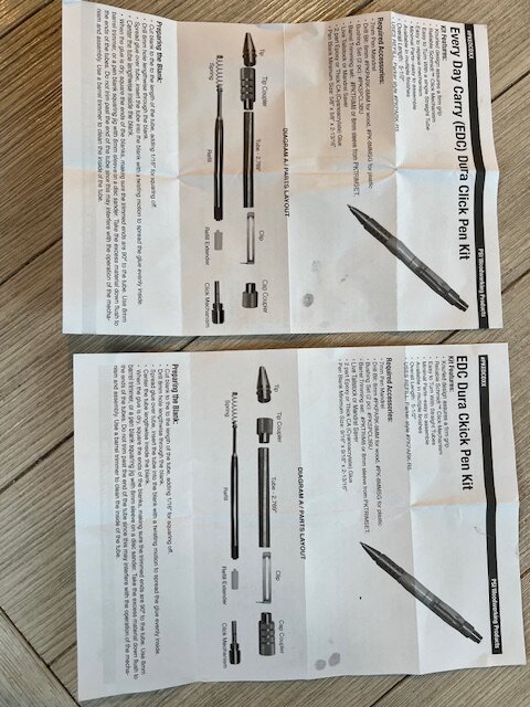

I also posted this in another thread, but thought it should be highlighted by itself after I received a reply from PSI
BAD INSTRUCTIONS FROM MANUFACTURER - BEWARE
I just ordered the starter kit for these pens from Exotic Blanks - 5 pens plus the bushings. I made my own blanks and proceeded to pull a random instruction sheet out of one of the kit bags. Following the instructions, I drilled, trimmed and glued in all the tubes. Then, following the instructions, I pressed in the first component, the cap section then the tip section on them all. Went to the next step which was screwing in the click mechanism - no dice. Seems there is a batch of bad instruction sets that reverse the picture and description of the tip and cap sections and I had a bad one! If your instruction set is titles EDC Dura CKick (SP) Pen Kit, you have a bad one. If it says Every Day Carry Dura Click Pen, they should have the right parts indicated.
I had to disassemble all the pens and reverse the section pieces, unfortunately ruining a blank along the way and requiring me to CA a few sections into the tubes because the brass had expanded from the first install. I've been in touch with Exotic Blanks and PSI about this - but if you have kits in your stocks and have never built this pen before, check your instruction sheet BEFORE pressing anything in.

I wrote an email to Penn State Industries regarding the bad instructions for this pen kit error, as I am struggling to hold Exotic Blanks responsible because all they did for this was fulfil my pen kit order. The pen kits were packaged at Penn State and shipped to Exotic Blanks, where they simply moved them from their inbound product to a box that got shipped to me. I expect, as I am sure Exotic Blanks expects, that the sealed product kit from Penn State would be complete and correct. Penn State doesn't seem to agree. I got the following response from them -
SUBJECT: EDC DURA CLICK PEN KIT INSTRUCTIONS ARE INCORRECT
MESSAGE FROM THE TECHNICIAN:
We are aware of a batch of kits that had bad instructions. All current inventory was pulled, checked, and corrected as necessary.

Odd in that their fix still got me 4 instruction sheets that were bad in my $80 order of 5 pen kits. Great customer service. Last order from Penn State product for me.

I appreciate the heads up on this, as I will be making my first Duraclick EDCs this week, possibly even tonight.
When you do, just be sure the larger brass connector is toward the tip of the pen. The smaller connector is the top of the pen where the click mechanism will be located. The pocket clip goes on the smaller connector before you push it into the blank/tube.
