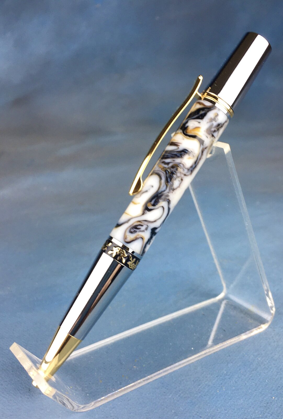

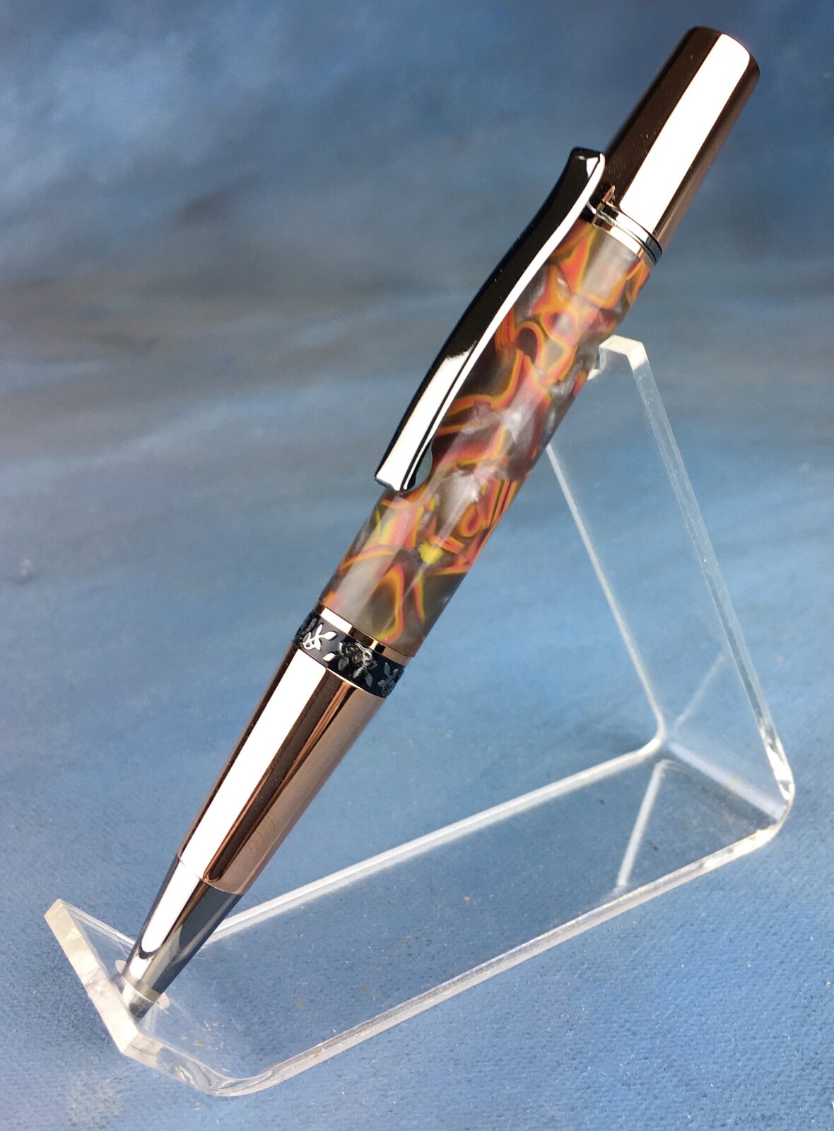

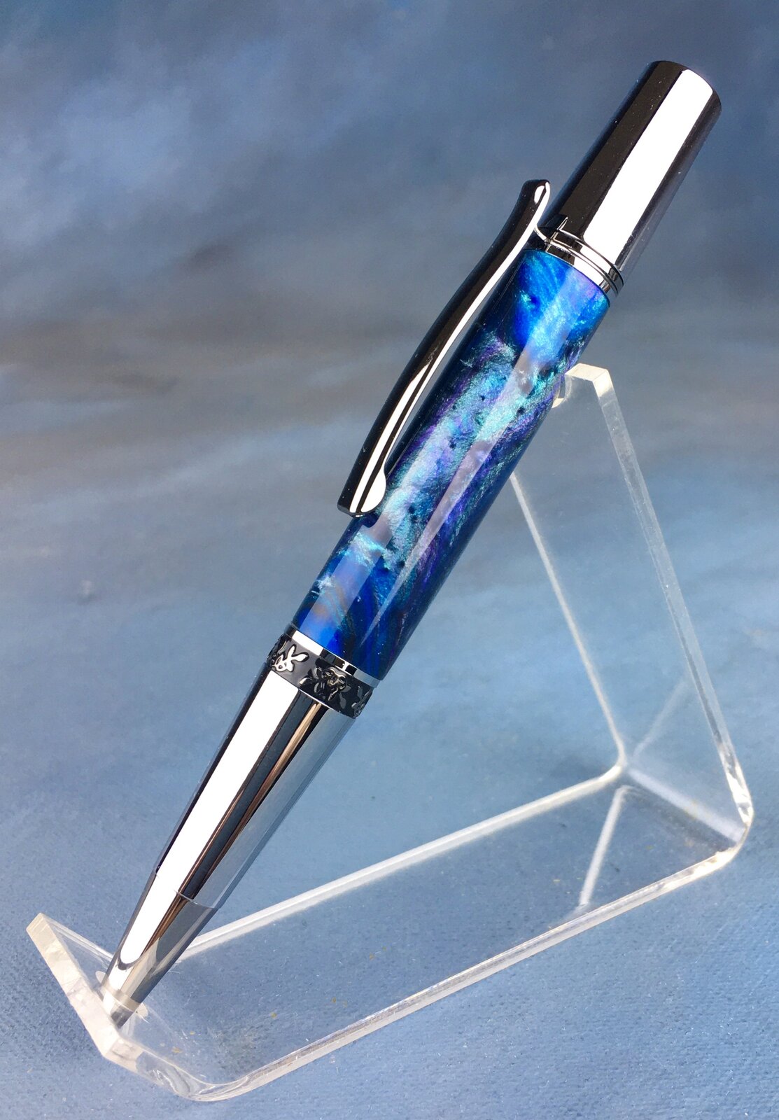

I bought three of these to use with segmented blanks bought from Mark James, the other Mark. Unfortunately they are built around different tubes and they sat for a while in the shop. I purchased stock bushings and had my wife select blanks she liked with the kits. Today they reached the finish line and I'll certainly buy more. I like that the kit smoothly pressed together, not too tight but tight enough to eliminate the need to glue the components. I also liked the thickness of the pen body compared to a stock Sierra. With all that meat there is little chance to split the tube when pressing it together. Lastly, the kits are first rate and to me quite beautiful. The ease of cartridge replacement by simply unscrewing the nib is a plus for a customer.
I am SURE many of you have been using them for years, but today was my "aha" moment.
The first two are inlace acrylester and the last one is acrylic acetate. All turned easily and polished up quickly.
