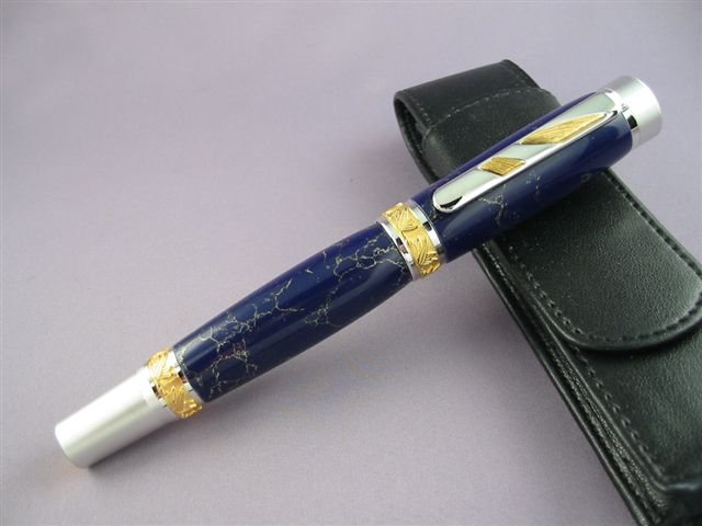

Hi,
This is another first pen from the elite line of pens that Craft Supply sells.
This is the Imperial, I like this pen a lot.
I chose a blue lapis Tru Stone for the body. This was very hard to turn, I resharpened my skew at least three times and rehoned the edge maybe 5-6 times per sharpening.
Again I like the pen, it has a nice balance and feel in the hardware, I like the frosted look as well on the hardware.
Again, an expensive kit but one I can see making a few times yet.
TBone

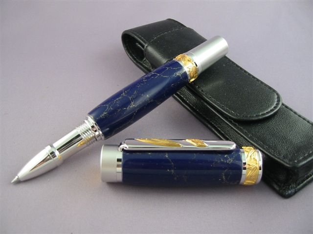

Pen looks very nice. I have used TruStone several times and never found it that tough. Are you using high quality steel tools ?
Dave
Aug 9, 2004
2,195
Oakville, Ontario, Canada.
Originally posted by txcwboy
<br />Pen looks very nice. I have used TruStone several times and never found it that tough. Are you using high quality steel tools ?
Dave
Thanks Dave,
This is not the first Tru Stone I have turned, but it is teh first Blue Lapis. It was REAL hard to turn. Considering I did it after a few red jasper's and a few blanco's I could tell for sure. I even took a different skew and weny with a heavier grind angle to try and get an edge that would last longer...all HSS tools in my shop...anyway, it took about an hour...wondering if it's the blue lapis or if some of the Tru Stone is just harder??
After I did the Blue Lapis I went to some acrylics and stabilized woods, they just flew!!!
Thanks for your kind words

SteveRoberts
Mar 16, 2006
771
Phoenix, AZ.
Originally posted by Jim in Oakville
<br />Hi,
I can't imagine turning a lapis with a skew only, I use my roughing gouge till I am just above the bushings, can do 3 or 4 before I have to reshapen. You have far more patience than I do.
Aug 9, 2004
2,195
Originally posted by SteveRoberts
<br />
<br />Hi,
Hi Steve,
I turned another blue lapis tonight and it was not as difficult...what can I say, that first one must have been Hard Boiled!!
