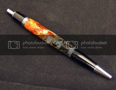

This is my first pic with the new light tent.
I guess I need to do a lot of reading on photography. I prefer just going out in the sun. The lighting seems dull in the tent, but when I put it on the computer, it is way too bright and the colors aren't correct.
I took several pics and moved the lights around and this is the best out of them.
Perhaps the LOML can do better. She takes some pretty nice pics and actually understands the settings on the camera. I just use auto. :biggrin:
Any tips on settings are appreciated.
