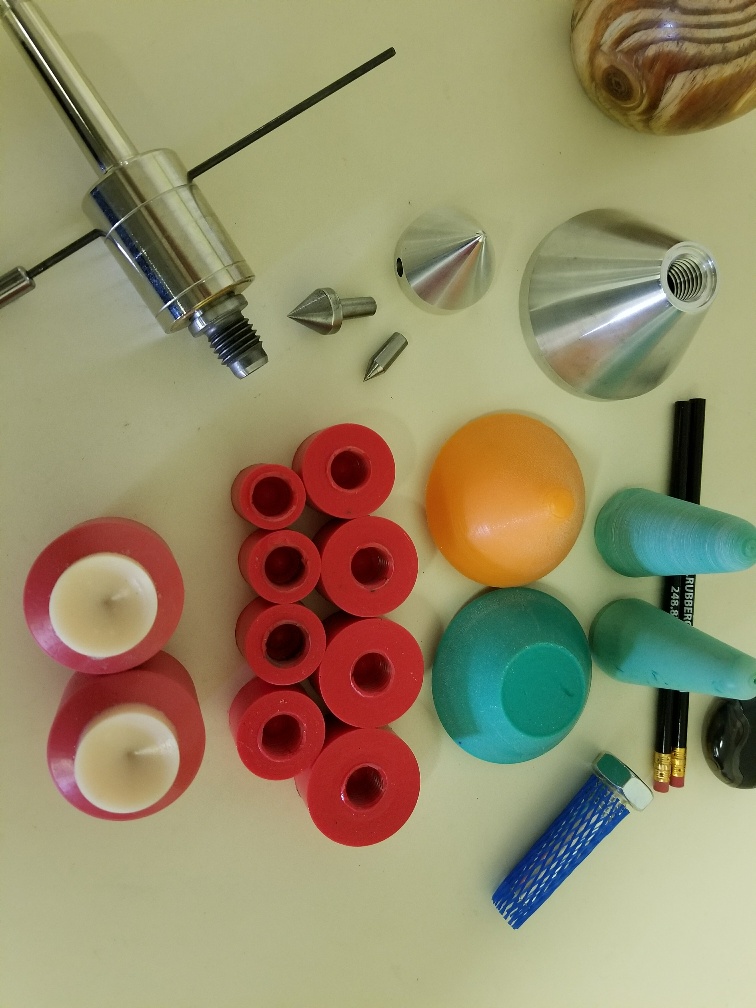

As for what I am doing, well. I want a large bull nose one as it is good for doing bud vase. I also want a long skinny one so that large bulky LC doesn't get in my way. I would also like a cupped one. I want to spray t with Dip-It to give it a rubber coating and use it for turning round thinks like globes. But mostly my OCD compels me. :D

I bought the PSI live center adapter - https://www.pennstateind.com/store/LTCA18.html. It was intended to allow mounting of a chuck and has the same threading as my headstock spindle - 1"x8tpi. So I can then turn threaded 'noses' that simply screw onto the adapter to provide whatever live center I want - cones, inverted cones, flat faces, concave faces (to match tennis balls when turning goblets), etc.

Has the same 3/4-10 thread. (I think it is) If it does then I would prefer this one as it comes with the large cone, and I can still use it with the Rubber chuck attachments. (not to mention I can make my own attachments) The guys I asked at Oneway hasn't replied yet.

Merry Christmas to me. :)
Oneway Live center from Peachtree, and chucks from Rubber Chucky.
