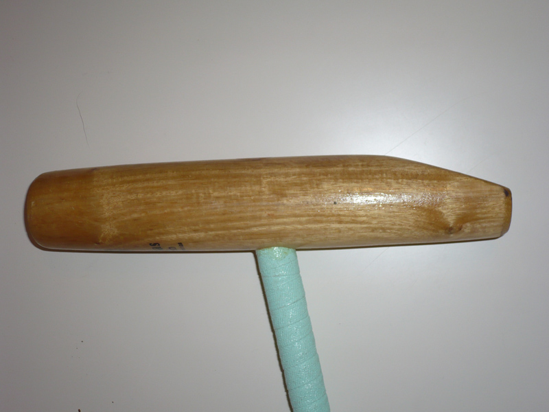

I'm gonna try my hand at making a Polo mallet. The head of the mallet is typically made of ash or maple. I'm looking for something a bit unique that can take that type of punishment (think baseball bat punishment). From what I've researched it would need to have a tight grain. Weight is gonna be the tricky part. Each mallet head weights between 160 - 200 grams, if you include the shaft and handle its around 530g. The dimmensions are around 47mm diameter by 230mm length. Anyhow, I'm just asking for various types of woods that I could further research. I'm not much of a wood person so I don't have much to go on. Thanks in advance for any help/ideas.

Not sure at all about polo specs, but in terms of wood:
Purpleheart is a very dense and hard wood. Mesquite is very stable....both are very pretty! :smile:
Here's a list of woods by 'harness'...remember that all wood is different, so species from different trees will vary according to the type of grain they possess, but it give you a ballpark..
http://en.wikipedia.org/wiki/Janka_hardness_test
Ash is 1320 on the Janka scale, so I'd guess that any hardwood above ash on the chart should do you fine

Cottonwod is light, and very hard. Also Apple wood is hard, and Persimmon comes to mind, it is what a lot of wooden golf clubs were made out of. Just my thoughts.
