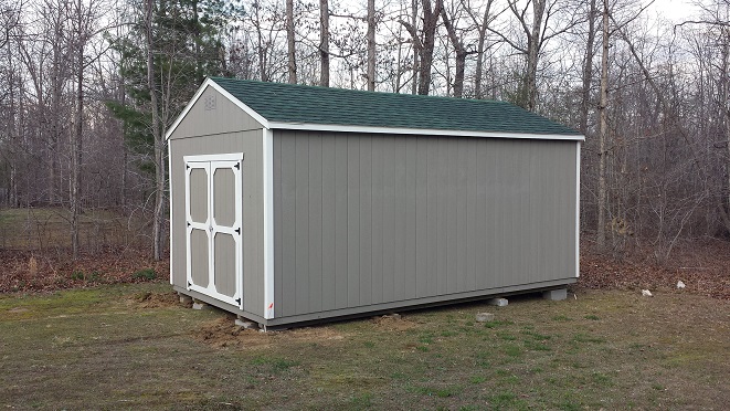

Delivery

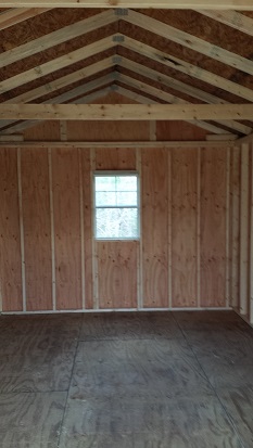

Finally, after over 4 weeks on order I got a call yesterday morning from driver to deliver my building. So here it sits. 12x20 building. Actual dimensions on inside are just under 11' x 19'5". It has 2x6 floor joists 12"on center sitting on 4 4x6 skids the length of the building for a nice strong floor. One 2 x 3 window in the back wall; shingle roof and painted siding in colors to match my house. Built by Old Hickory Buildings LLC.
Will put in ceiling joists Friday along with getting everything ready to start electrical work early next week.

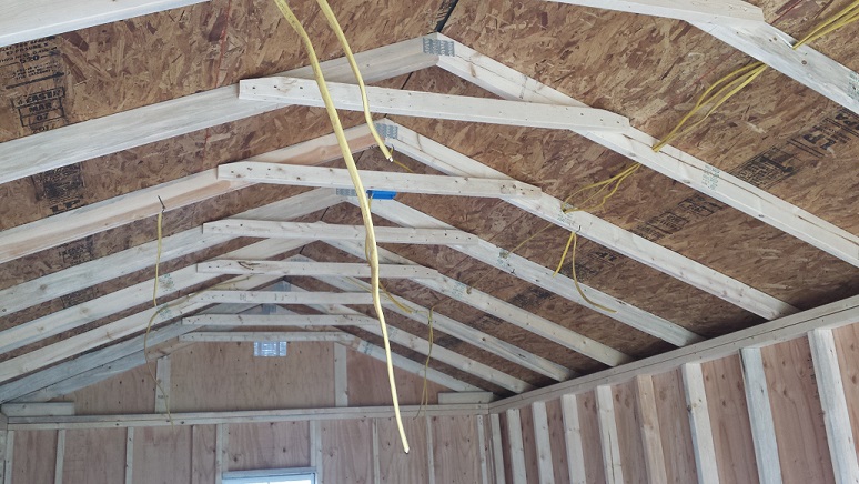

I considered just putting it straight to the rafters but the rafters are only 2x4s so with r 13 that will be right against the underside of the roof and no ventilation. So I'm going to drop it a little just not sure how much.

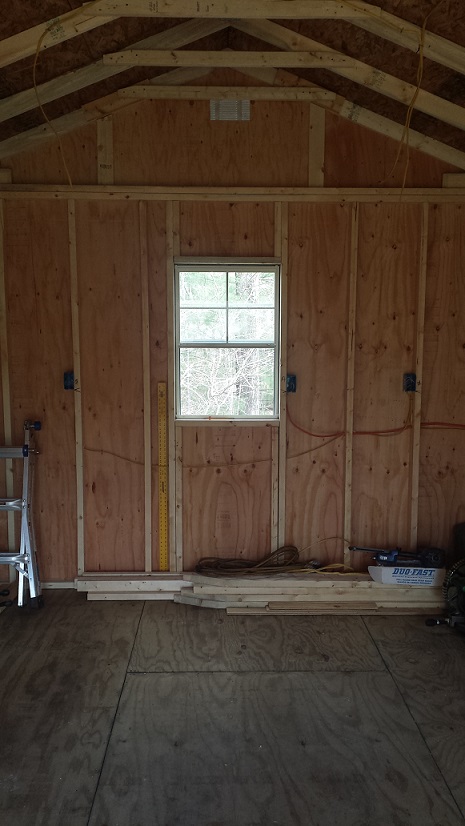

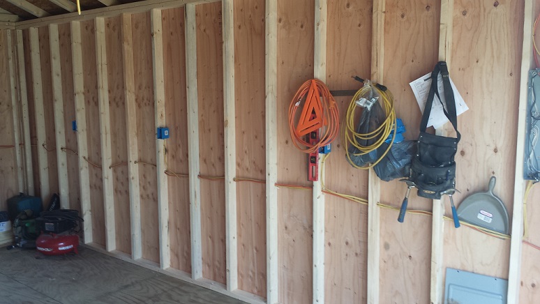

Friday was a busy day on my building. I got the electrical work roughed in. Going to have 100 amp service. I have a dedicated circuit for my table saw, one to the rear wall for AC and one for Dust collector. Wired for 6, 4 ft lights. Also one switched outlet in the middle of the shop for air cleaner. I have boxes about every 5 ft down each wall.
I decided to put Styrofoam insulation in the ceiling and raise the ceiling up. I have 9ft 4in of clearance in the middle of the floor. Just got to get insulation and sheetrock up an Ill be moving soon.

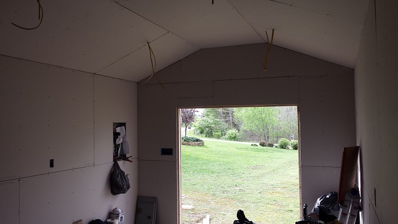

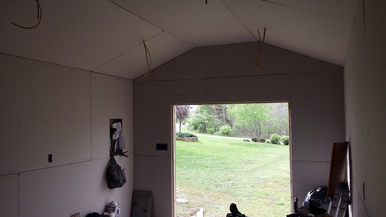

got a lot of progress over the weekend and today. Got it insulated on Saturday. Then my dad came out and helped and we got the drywall all hung today. I have pics to upload but will be tomorrow.

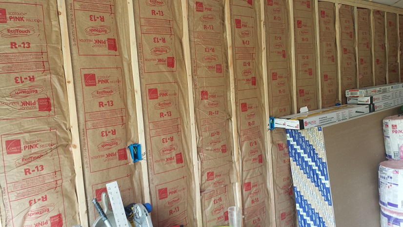

I only took a few pics of the insulation and this was the only one that wasn't blurry. This is standing in the door looking to the left side wall.

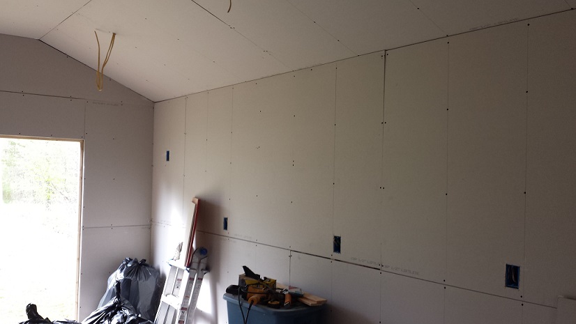

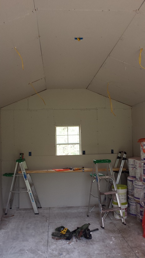

Drywall is up.
Looking toward the back wall of the shop. Ceiling height is 9'4" to the middle. The outlet in the center of the ceiling is operated by switch. Plan on hanging air cleaner up there. Have 6 light fixtures. Going to hang 2 bulb florescent fixtures.
Standing in back corner looking toward the front with both doors in front open. Electrical service (100 AMP service) comes in on front corner.
Standing in back looking along opposite wall. The outlet near the front door that is higher on the wall is dedicated vac outlet. Have plans for cyclone dust collection in near future. It will be located in that front corner with dust collection piping running along this wall.
