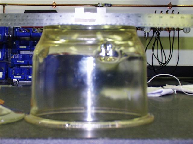

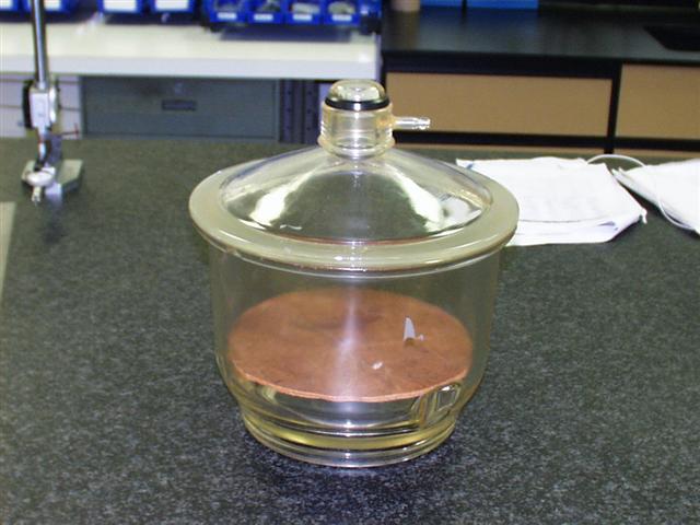

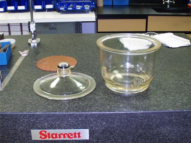

Here is our oldest vessel used almost daily for the last 26 years. I have used it for 10-1/2 years myself and it appeared to be older than dirt when I started.
BTW: if you look closely at the rim you will see chips and nicks in the glass.
What do you think?
