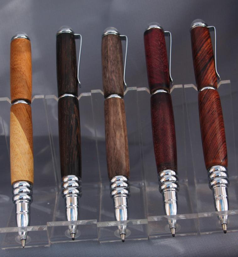

No, not cheesecake -- cute little pocket pens I ordered from Aaron Lau. All the blanks are ones I swapped other IAP members for. From left to right, they are bamboo, wenge, black mangrove, purpleheart and cocobolo. All were MMed to 3600, 4 coats of CA/BLO, then Beall buffed with Renaissance Wax.
They do shine, but it's a cloudy day here, and all my photography is outdoors since I don't have photographic floods/spots.
Comments welcome.

I thought it was going to be a 'Girls of the IAP' thread. Dang.
I'd like to see one with the cap on. Hadn't seen one of those before and the wood exposed looks odd. Probably not as noticeable with the cap on.
