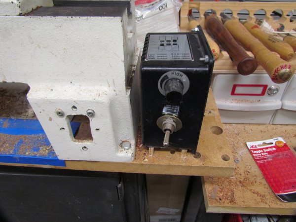

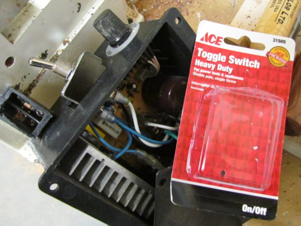

Well I'm operational again!
Thank you everyone for the tips and suggestions and Randy, that PDF file will indeed be filed away for future reference. It turns out that the on/off switch was indeed the culprit. When I opened the switch itself the body just fell apart. Obviously there has been a lot of arching between the contacts since all the rubber and plastic parts were smoked pretty bad and the contacts were shot. I didn't bother cleaning anything up, instead headed for the local Ace hardware and they had just what I needed.
If this ever happens to anyone else, the switch is available at your local Ace hardware as a Heavy Duty Toggle Switch, Double pole - single throw, part number 31505.
I thought I was going into panic mode since a lady dropped by yesterday Christmas shopping and bought a few pens and 27 bottle stoppers, 12 of which were already made but 10 needed to be made. It never dawned on me to just use my larger Jet lathe! First time it's been turned on in two years and actually was fun using, the variable speed goes all the way to dead stop and reverses when you need to unscrew a stopper from the mandrel so.......all in all, it was a good day!
