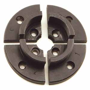

Your idea gave me an idea... What if I build my own chuck like this...
Take a waste block, and attach some replacement jaws
to it. Then whack the drive center in the back?
Would that work?

Originally posted by mbellek
<br />Hello! How bout this:
http://www.woodcraft.com/family.aspx?familyid=292
Melainie, dead centers exist because that is all that was used for centuries before live centers were invented/developed. They work fine but not up to our current standards.
Take a good look at those ads in your link. They are jaw sets for use on the chuck. You still have to buy a chuck to use the jaws.
Yes I know that, I can read!![:D] The point is that why could I not bolt them down permanently since my blanks are always the same size, being that I cut them myself. Essentially the replacement jaws I was talking about are simply pieces of metal that are in the shape I need. I'm saying basically why could I not construct my own chuck, except the jaws would be stationary.
<br />.....The point is that why could I not bolt them down permanently since my blanks are always the same size, being that I cut them myself. Essentially the replacement jaws I was talking about are simply pieces of metal that are in the shape I need. I'm saying basically why could I not construct my own chuck, except the jaws would be stationary.....
Melanie: You certainly "COULD" do that; but why go to the added expense of purchasing a set of jaws when you could accomplish the same thing by using a couple(actually four) pieces of scrap wood??
