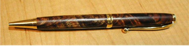

Fred, By hard to drill I meant hard to line up in the vise. Because it had such a bow in it. It drilled just fine and turned well. The Koa is a very nice wood. The blanks I received was bad. In the picture you will be able to see that I'm just a tad large on the tip end. I'll correct that on the next one. I love this little pen and the Koa too.
Thanks for your help.[:)]
