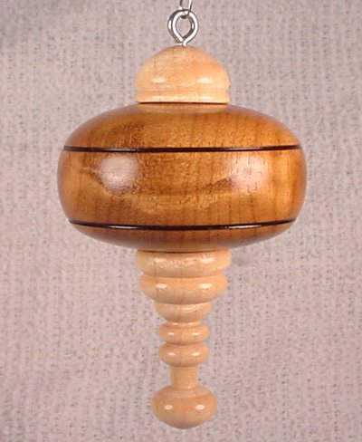

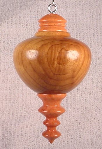

I had some more interest in sales so I thought I better make a few more ornaments. These are both Myrtle, first one has maple finials and the second has carob finials.
Thanks for looking, and as always comments welcome.

Kevin,
Look real good. After having turned about 45 of these this year (all for gifts or our own tree, no $$$ coming out of it [:(]) I feel that I have become a conissuer of shape and style, mainly since no two of mine ever looked alike. That was not neccesarily on purpose, just a fact of life[;)]. I really like the shape of the top one better for the ball, my wife tells me that I prefer the "squished" ones (sure glad she told me what I like better). However, I like the bottom finial on the bottom one better. Both look great, as did your others, but just a matter of personal preference in case you wanted to send one to me [:p]. I did not think about burning the grooves for decoration, that is a nice touch.

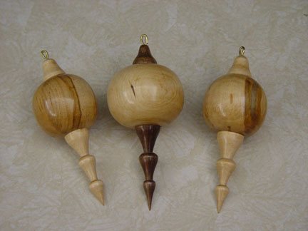

I agree about the shape of the scraper's shaft. I have two that have round tool stock, and I always seem to have a hard time keeping it level. I had good success but it wasn't great. Then I tried this one from Hamlet through CSUSA, I had bought it to turn the inside lips of some lidded boxes I was making- http://www.woodturnerscatalog.com/cgi-bin/shopper?preadd=action&key=247-0099 It does have a wide flat stock that rests very nicely on the tool rest. It really increased my success with consistantcy with wall thickness and is much easier to sharpen. They actually have 4 slightly different shapes, I use the thinest and narrowest one. I start by drilling a 5/8" hole all the way through which is about as small as I can make it and still get the tool in far enough, and I can use 13/16" stock for the finials. Here is the picture I posted in another thread of few of mine, all birdseye or ambrosia maple with maple or walnut finals-

I too like the squished ball look. But these were both kind of experiments. The top one was the burned line experiment and the finial was an exercise in beading. The bottom I was just trying a different shape. Besides I didn't have enough stock to make two more and didn't want to waste any wood so I stretched it out a little. I may try some beading on a bulb pretty soon though. Stay tuned..
I use a 1/2" hole to hollow through which allows me to use pen blanks for finials.
