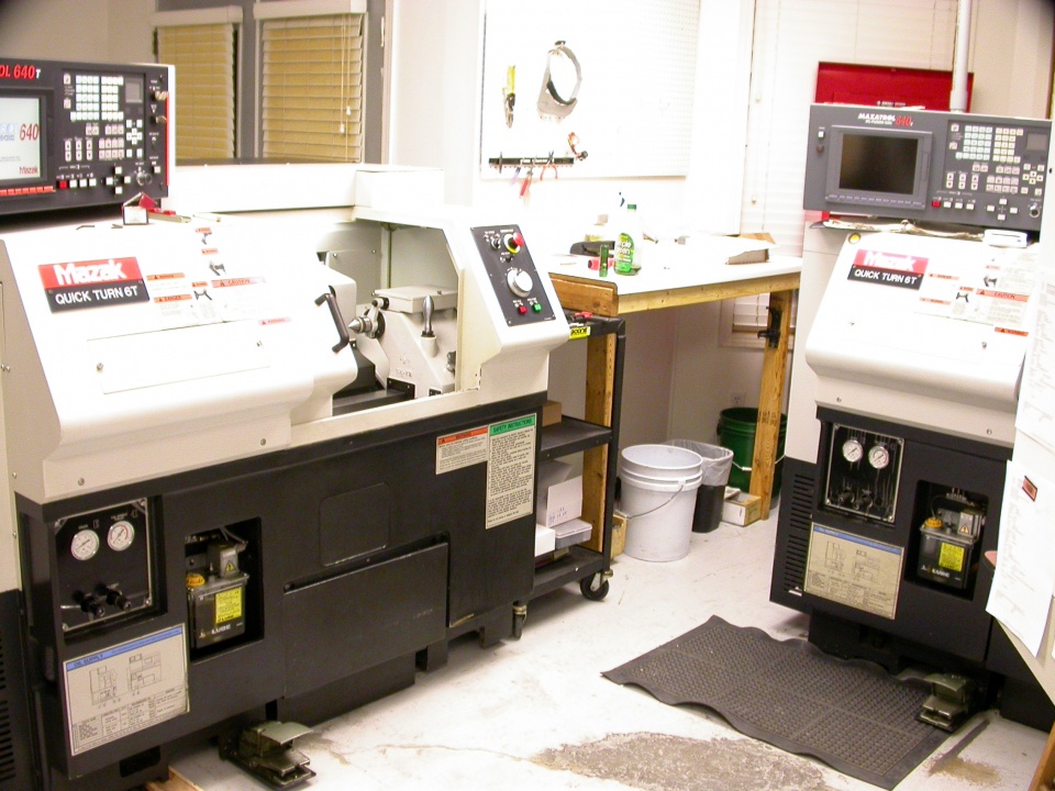

Here's my new metal lathe next to the old one. :smile:

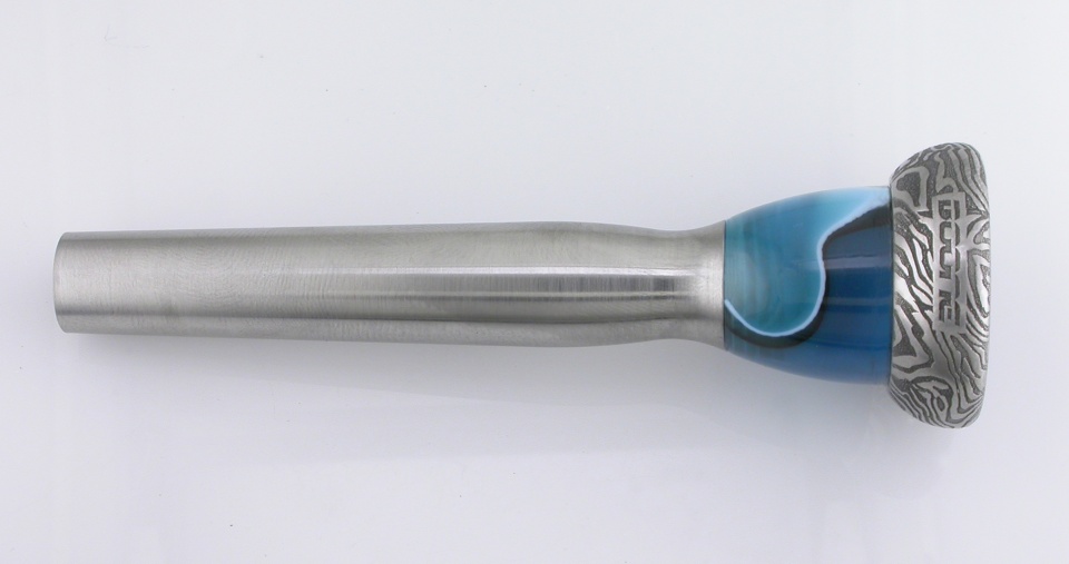

I'll be working on some titanium trumpet mouthpieces.

It does nice turning. The real machines also do full 5th axis milling and turning on a back facing sub spindle as well. In time...
When you say "new" next to the "old", it makes the "old" one sound worn out and needing replacing by the "new" one. I'm guessing that the "old" one is still producing just fine and the "new" one is to increase capacity.
Do you run both machines by yourself at the same time? I find I can no longer run multiple machines simultaneously without exponentially increasing my scrap rate (and of course, none of my machines are as nice as yours).
Congratulations on the new addition.
Ed
Ed, that's correct, the old one works fine. They can hold a thousandth of an inch for weeks at a time. It is to increase capacity. Because we run titanium, we've found that tools last exponentially longer if you don't run them very fast, so there's plenty of time to run a second machine. There is a limit to what can be run at the same time, but the lathes should not run into that issue with our normal stuff. It's also about having a backup machine, one where I can set up different tooling situations without interfering with our production tools. The only time I crash or ruin tools is when I'm trying new stuff. That would affect our ring making, which pays the bills. On the mouthpieces, I need to do a deep drilled hole with a long taper. This will take a pretty extreme setup with 7 drills and a $1300 special ground reamer. I can leave that setup on the machine long enough to do batches of parts without cutting into wedding ring production time. Once it's dialed in, I would leave it alone, even if it meant having the machine idle for a week. It's still more cost effective than having to dial in every time and risk ruining that reamer.
Mazatrol is really great for 2 dimensional stuff. Draw the part and it does the rest. Very easy to dial parts in. I had a Mazak years ago when I made bike parts. I believe there is no better lathe out there, so I don't even want to look at the Okumas and Haas and other lathes. The engineering is impeccable. The electrical cabinet is all perfectly arranged with nothing out of place. This was one of their first models where the spindle is the motor, so there's no gears or belts. I think all their machines have gone to that now.

I finally got the Mazak guy out to unlock the machine, tooled it up, and cut my first part on it today. Hopefully I can figure out how to copy programs from the other machine so I won't have to rewrite them all. It's nice to finally be up and running.
Do you do your design work on the Mazak control computer? I would have thought you would have a separate dedicated computer somewhere with your design software and you just sent toolpaths to the lathe control computer / controller.
Ed
I normally design my rings in CAD. I get the necessary dimensions from that. Most shapes are simple, si it's a matter of defining lines, arcs, and tapers by their start and end points. The lathe figures out all roughing and finishing tool paths including cutter compensation by using smart parameters based on the materials and tools used.
