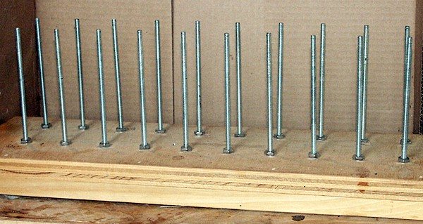

Actually you don't need to buy additional bushings or mandrels... you can use a rack like the one below I made for when I do a production run of pens... when the sealer or poly is dry to the touch (about 10-15Min), just take them off the mandrel and put them on the rods in the same orientation they were on the mandrel.. This way you know which end is up when you put them back on the mandrel to sand them...
The rods are 5" long #8 bolts with a washer and nut to lock them to the wood.. This system works like a dream for me for doing multiple pens... and it is a whole lot cheaper than new mandrels and bushings.. I can do 20 pens at a time with this set up...
