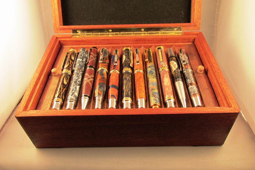

...and then I put them in this.

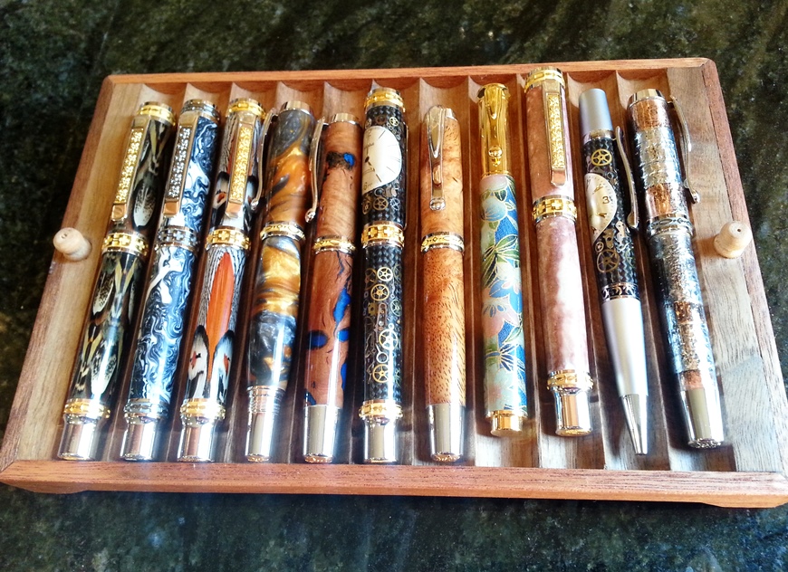

I wanted to make a pen case for the coffee table.
Outer frame - mahogany lined with felt, rabbited top to bottom

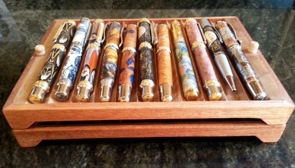

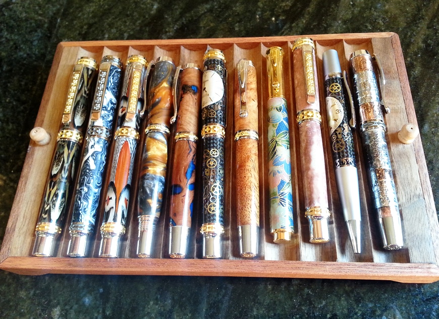

Trays - walnut trimmed in mahogany w/wood posts to grab on to lift out. Box holds 2 trays

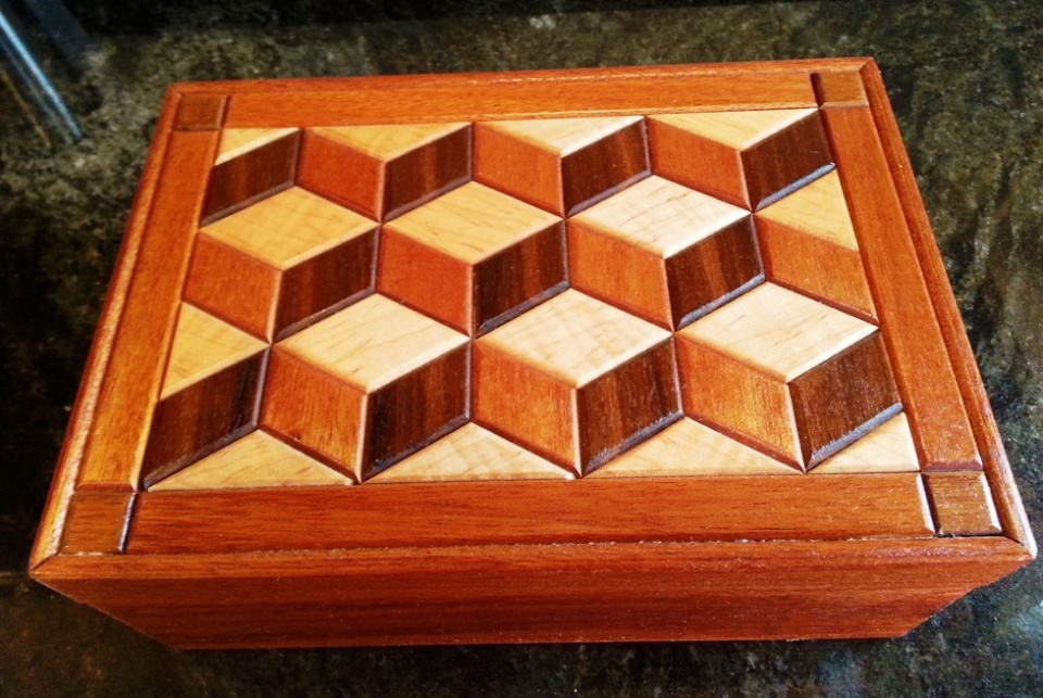

Top - tumbler blocks are individual walnut, mahogany, cherry. Trimmed in mahogany w/walnut corners.
Sorry for the ugly pics...still studying the lessons that Eric wrote for us. Someday I'll get there.

Great work Bob! Funny though it wasn't too many months ago and you were raving about how great Ballpoints were and yet I only see one ballpoint in the pic.:biggrin: And where are all those slimlines at?
Do not see any slimmies but I do count 3 ball points -- and the watch part one is very very nice indeed - The other two "ain't no slouches" either.
Very nice pen case. I'll bet most people would not know what is in there or even be able to guess.
And BTW, why on earth would be put 'slimlines' in a case like that?:confused:

The blocks I had seen a few years ago but were done in actual 3 dimensional squares that someone stacked up and glued. I just had to figure out how to do them on a flat plane with the sides being parallel. I bought some colored baby blocks and cut them into slices on my table saw, laid them flat and projected the lines to meet at a common point and measured the angles. All of a sudden the light went on. Each one is about 3/32" thick glued side to side with a veneer backing. There was a lot of "adjusting" and "re-do's" as I went along trying to make points on the blocks meet at the edge of the box.

Super box Bob! Now you have to make sure someone doesn't nab that box!
Wifey (Mrs. Charlie_W) wants to know why you chose a tumbling blocks quilt pattern for your box top.

No worries. The 3rd pen from the left is the pheasant blank that I got from JohnU and belonged to me for about 30 seconds. Same with the pink alabaster one 3rd from the right. Both are in the box and belong to the boss now.....you fight her for it, not me!
As for the pattern, I promise I saw it made from stacked up 2" cubes before, unless I am a "closet quilter" and just don't know it yet. Nooooooooo!!!!!! :eek:
Nice looking pen box. And the pens inside ain't too bad either.
It's not a quilt top. It's intarsia! Yeah, that's it!
I like the way you think!
Did you read this Mrs. Charlie? It's intarsia, not quilting, I'm not a closet quilter after all~ Whew!
