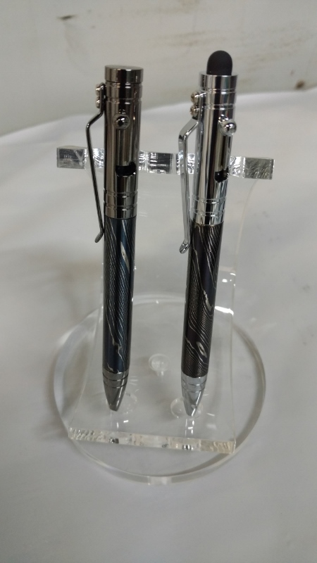

To appeal to my military side here is the bolt action tec pen I tried out, turned out pretty well I think, it should be a good seller. I will probably make it a staple piece for my shop. just wish they had it in a pencil too.

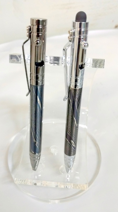

Vincent, I had to lighten your pic to see the pattern and it revealed the cool blue hue on the first one. What metal gives that colour? Looks great btw.:wink:
The color comes from the hot niter bluing salt bath. I watch it turn and quench in water once I hit the color I want. the silver is N201 and the other is 1084 HC
