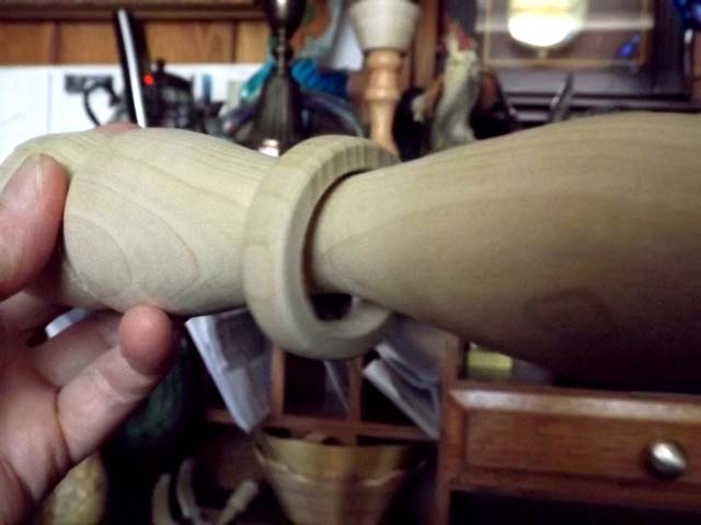

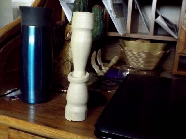

I was messing around with this today and I finally got my first captured ring made. I used a combination of tools to get it done and that was time consuming so come payday, I will get the captured ring tool. Saw one in the PSI catalog that I got in the mail one that cuts 3 different sizes of rings. So I'm going to order that one I think. I could not get the parting tool in on the left side so it threw the wood off balance and the sanding did not go very well, but hey! I wanted to try cutting one and I got one done. Have a look Fay

Well first off, I didn't even think to make a captured ring tool from other tools. I have a whole bunch of allen wrenches in different sizes. How would you make the tool? now the answer to the next question.. I rounded the wood while it is on the lathe, Then marked off the section for the ring with a pencil, then marked the rounded part on the ends of the wood, ( I did not finish that part as the wood got knocked off balance so that part did not get done.) Then I use the parting tool to cut on each side to he marking for the ring. You can make it as wide or as narrow as you want to.. Then I used the spindle gouger tool to narrow the wood down to the ring section and then I used the parting tool several times until I got the depth that I wanted, Then rounded the ring and then went ahead and worked more on the taper on each side of the ring. Then with the skew I started cutting in at the taper next to the ring but cutting inward. Switched between the parting tool and the skew and you have to be very careful because it is hard to get in there with the parting tool. It's a challenge but I should try making my own tool to cut that ring for the heck of it... Fay

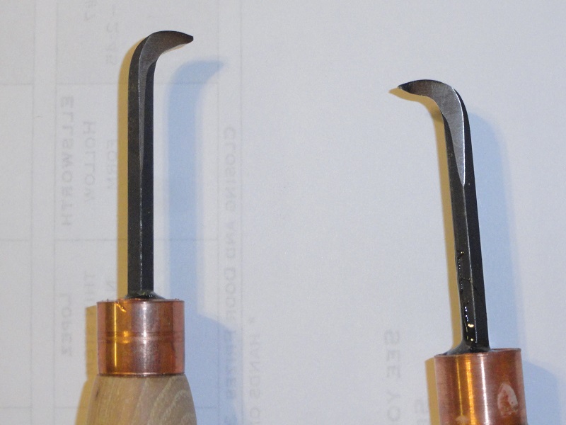

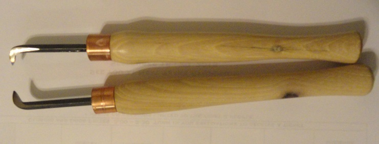

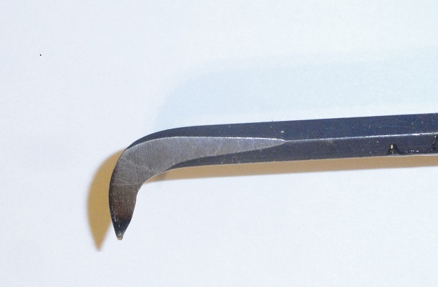

Allen wrench captive ring tool.
I hope nobody thinks I am hijacking this thread as I was asked about the tool in the thread by various people.
:smile:The first pic is a closeup of the grind on a HF allen wrench for the right side of a ring tool.

The second pic is the pair you need to do a captive ring the right and left cutter.

This last pic is the allen wrenches with home made handles with copper pipe ferrules. Very simple to make you just need two allen wrenches the same size.

Sorry truckerdave I do not have a video camera. But yes they are grinded only on the top. They act kind of like a scraper the bottom side is relieved very slightly just to prevent catches. Kind of like a negative rake scraper. If you look at the Sorby tool the ring parts (3 different sizes) really look like a flat scraper and are grinded on both sides to eliminating having to have two tools (left and right). But the Sorby cost a lot more than allen wrenches and if you are doing small items even there small ring tool is very large. It works but to tell the truth I have not used it in years since I made the allen ones.
