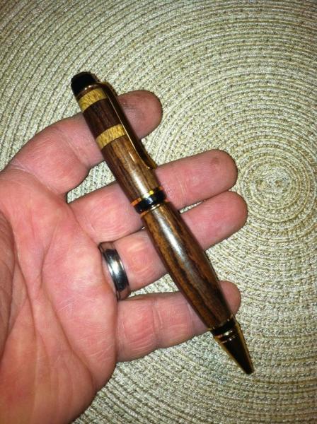

Thanks for all the great ideas, no clue what the size bit that I used. Had already tossed it back into the "normal" drill box out of frustration. My problem was the slimline blocks weren't long enough for the other kits I had on hand. Picked up a couple Cuban kits and tried my hand at adding a few segments to the upper barrel. I really try to take my mistakes and turn them into learning experiences. Here's what I came up with...
