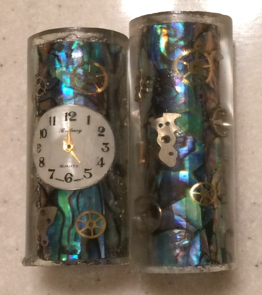

That would be a nice earning! I recently cast an abalone with watch parts for myself but haven't gotten around to turning it yet. I've alway liked the carbon fiber background but I think with the right watch face the abalone really pops and is a nice change.
John those came out well. You need to spin them. The watch dial is the whole key to any of these watch parts pens. That to me is what makes or breaks a good looking pen. Throwing a bunch of parts in there does not do it for me.

I have done a watch parts pen with a wood background. It is a real fine line between getting it thin enough and hitting the brass tube. You end up with about .012" of wood left. I used 400 grit paper for the last part and sanded between the delrin cones so I could get all the way to the ends.

I agree, the face is what makes the pen. Unfortunately I haven't invested a lot in faces yet because I haven't spent a lot of time playing with the process. Mine were some freebies from a friend that found a small bag of watches at a garage sale. lol
