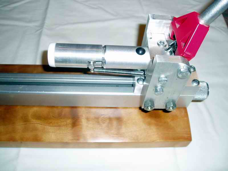

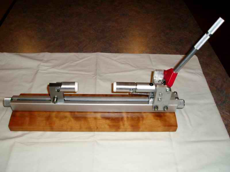

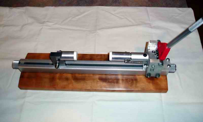

Here it is :)
Got any more shots showing the details of the workings?
Very interesting application.
Is the ram at the handle end, thus the spring for the return? Where did you get such a small hydraulic pump/ram?
THANKS,
Barney
Titan, I used a ram and handle from one of those little toy floor jacks from the local auto parts store. This sucker pushes pens together with almost no effort at all. The poly pads are also replaceable, I used nylon chair pads for those. I will try to take a few more pics and post them.>>>>>>>>JK
