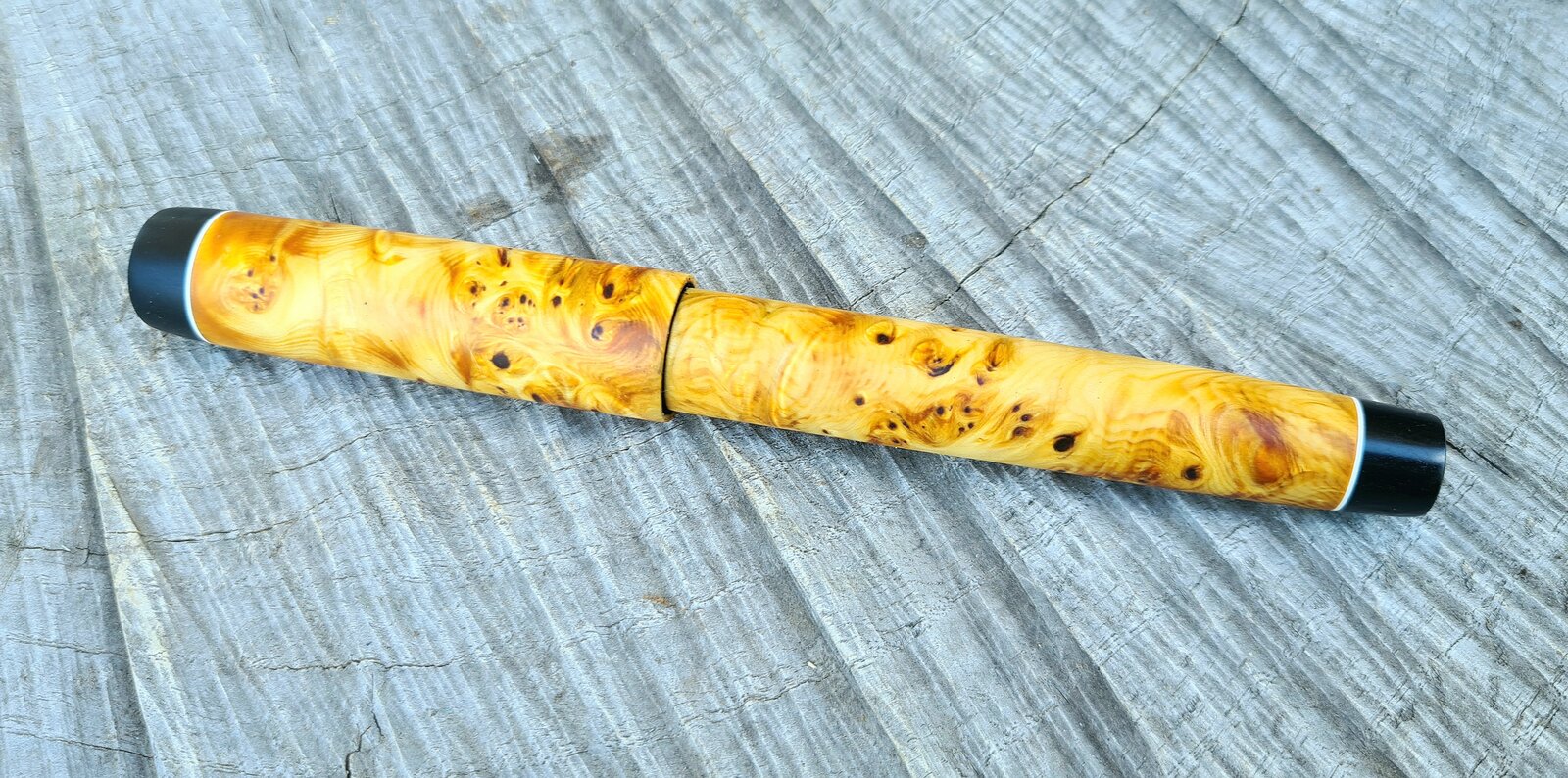

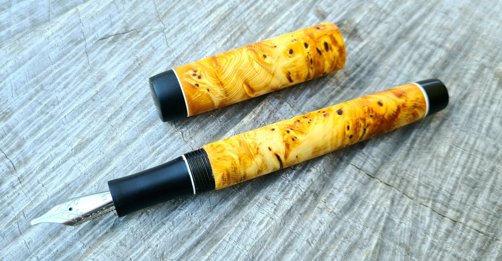

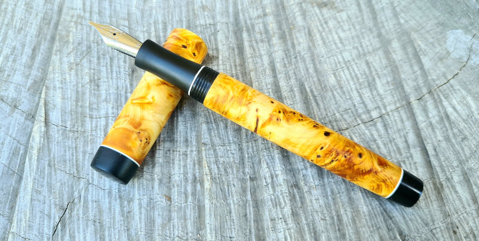

Another custom pen, all materials chosen by customer, and this one came up awesome. Black ebonite, matte finished, stabilised huon pine burl, lined and sleeved with ebonite.
The black ends really suit the pen, give it great contrast.
What are your thoughts?
Casey.

Another stunning blank with superb accents Casey! I really appreciate your skill set, (but miss the hands - never bothered me at all; just another 'shop shot' which used to be appreciated in days past on IAP, sadly not now). The Huon Pine is really impressive, well done. 👏 👏 👏 . The Ebonite is a great counterpoint to the Yellow Pine. Be well, Mark
