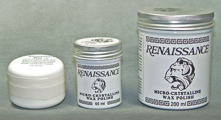

how would you use this,i think i'm doing it wrong
Pen&FishingCT
Sep 17, 2008
222
either making pens or fishing
i finished the pen,micromesh,boiled L/O then CA glue,i put the first coat of this, but after i buff it,the finish its not even,i've done it in several speeds and the same results.. the wood takes a good amount of wax but some parts doesn't. so its pretty much like if the pen is peeling off.
what am i doing wrong? who got a better way to use it.ideas please.:crying:

I put Ren wax on right after I assemble the pen. I dip my finger in the can and apply it, with my finger, to the whole pen, metal parts included. I immediately buff by hand with a soft cloth. I have the big can and have made about 300 pens using it and it's still half full. A great bargain if you ask me.
Exactly what rick said is how the insructions read. I just put it on on the lathe (after finish is dry) Two coats and I am very happy with results, many will say it is not worth it. But as rick points out per pen price is dirt cheap....

Dave, When using Ren. Wax put on thin coats. Don't use it thick. A couple of thin is a lot better than one thick. I usually put one thin coat on while on the mandrel & buff & another after assembly & use the buffer wheel.
Can you put on successive coats? I thought I read somewhere that when
you put it on, it takes off the previous coats .. maybe I read it wrong.
Or maybe it was a dream.
.. no, wait .. that wasn't me
