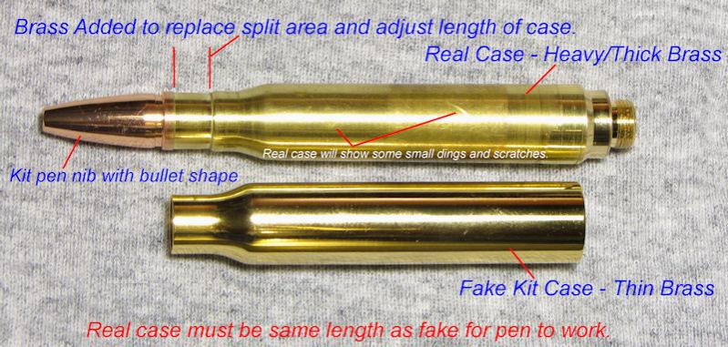

I am converting an empty 30-06 cartridge to a bullet pen. I am using this kit:
(THIS IS NOT MY PEN, ONLY THE PICTURE THAT THE VENDOR SHOWS WITH THE KIT.)
I will be using every thing in the kit except the casing shaped tube. This is a progress photo I sent to the customer. She gave me the casing because it was her fathers and she wants to give it to him for fathers day as gift pen.
All the markings and labeling are for the customers benefit.
The real casing of course does not have any protective coating on it. after I get it more or less shined up (I am leaving some distress on it) what would you recommend that I coat it with to keep it from tarnishing?
