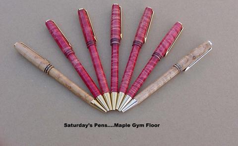

I make several red pens for a local high school. I use curly maple and dye the wood with red aniline dye and finish with CA. I like the result. Here is a picture. I'm sure the dye comes in purple. Purple and red PVC rod is also available.
<br />
Do a good turn daily!
Don

Thanks Mike and Greg. Those pens were turned from maple flooring that came from the gym floor where I taught high school mathematics. The gym was destroyed in a tornado in 2003 and I was able to salvage several hundred feet of the most figured boards before they were hauled to the dump...70,000 linear feet of 1" solid flooring. The gym was built in 1962. I wish I had the room to keep all of it.
Haven't tried oak flooring, but I have tried other types of flooring. Oak is just not a very pretty wood (usually), although I have found some really nice spalted or figured oak in which case makes nice pens.
