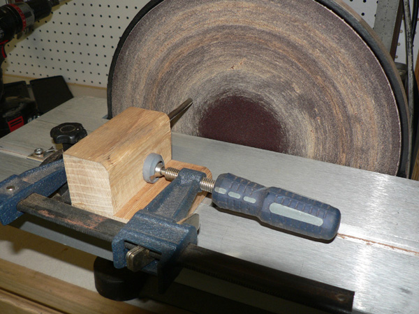

This is the jig I made for my disk sander after I damaged a number of blanks with the barrel trimmers. It works great for me, now the trimmers don't even come out of the drawer. I use trimming sleeves for the pen that I'm turning.
