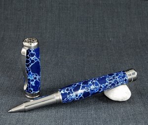

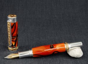

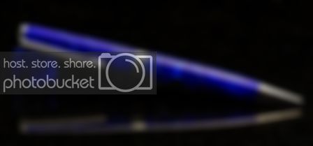

Here is a pen made yesterday and a similar one made a while ago. I think they show a decent amount of glossy shine. If it looks good to you I'll describe or show the setup. It was illuminated by one high intensity lamp I use while turning and the shop lights in the ceiling of my garage ( yes, mixed light sources) with the digital camera set for auto white balance. CA on wood or acrylic are both usually shiny so I showed a couple of pens with visible reflections.

Getting the shine to show is really a reflection. A flat light source like the lights in your shop will not get the job done. As one said a high intensity light (point light source) is what is needed. Move the light around to get the desired look. Look at your subject pen from the position of the camera.

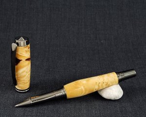

On getting the reflection, be careful not to put too much light on the pen or the metal parts will wash out. I've come to use indirect light bounced off white panels to to provide reflected diffused light for the reflection like in these past photos I've shown here on the site.

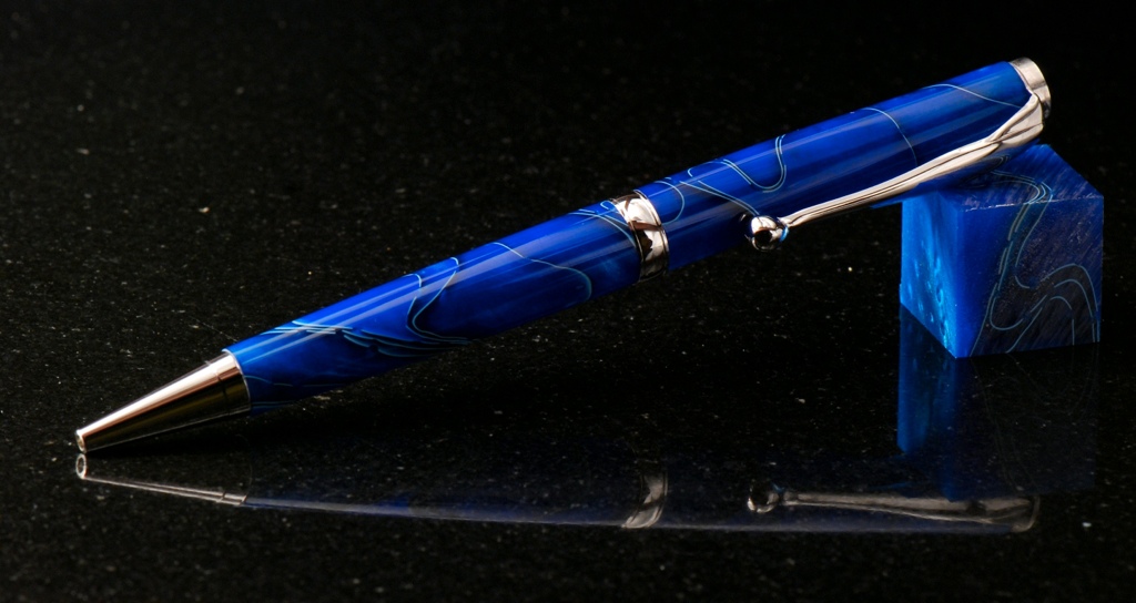

Here is a photo from my setup of two "his/hers" pens in bocote
The above image was taken on manual exposure at f22 for 1.6 seconds.

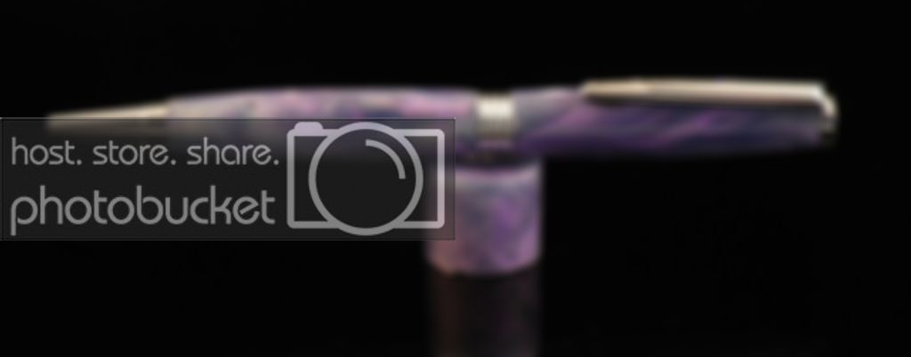

This thread is about adding shine to a well turned pen so I tried a quick experiment with a purple pen today. The first photo is my normal setup showing a smooth front lower side of the pen.
Here is the same setup with a long thin horizontal highlight near the center.
It is subtle, but shows off more shine to me. Some may argue that it looks better or worse and they may be right. The point is that more surface shine was added.
To do this fold a clean piece of printer paper into 1/5ths so that it becomes a slightly irregular (non-origami) rectangle. Place is if front of the pen aligned parallel to the pen JUST FORWARD TOWARD THE CAMERA - OUT OF SIGHT. If correctly folded, one surface will touch the glass below the subject and the other will face the pen. Move it in and out until the highlight appears. Evaluate if it helps or not and shoot it.
