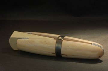

This is a Ring Clamp. Used by goldsmiths and silversmiths. Used for exactly what you're talking about. Rio Grande, or other silversmithing stores have these, BUT, take a look, you could make one very quickly.
Thanks,
Tony
Gilbert, AZ
That thing made me think 'clothespin'.
