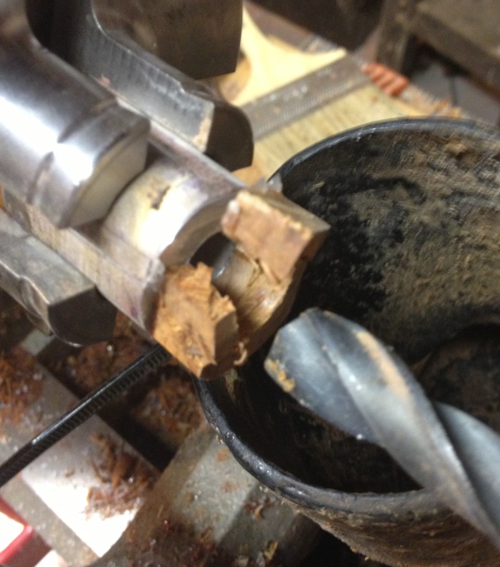

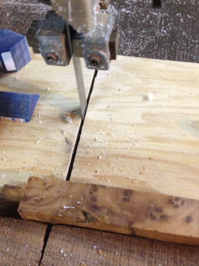

Ok so sometimes the worse happens.

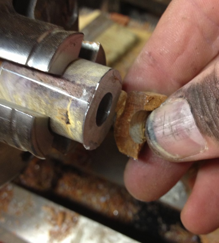

Ok so remove the rest of the segment you may need to even use a parting tool, I got lucky here. I used a pair of pliers and worked it off..

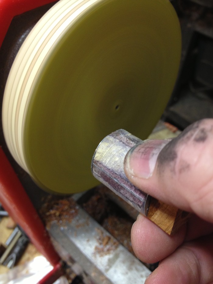

Now clean up the mess. I made a sanding disk that I use to square blanks so I also use it as a disk sander.

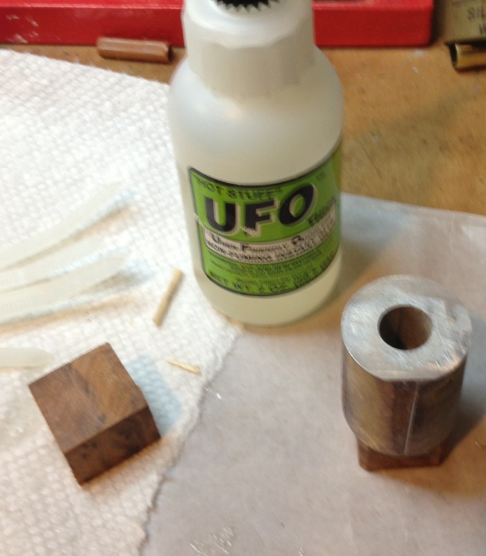

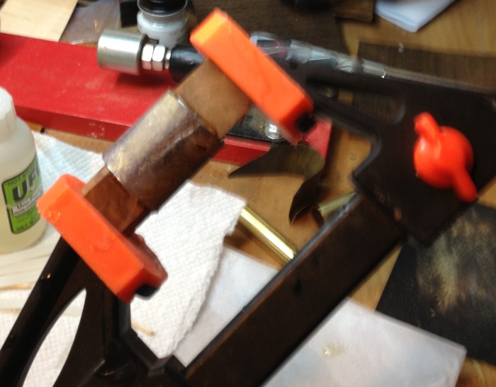

Ok get a new piece and replace the old.
Now I have a hole drilled the entire length of the blank. So after things set up I am going to put my blank back into the chuck, turn those corners off the new piece so it is out of the way of my chuck. Turn the blank around and insert it back into the chuck and I have my drilled hole to use as a guide to drill the new piece. That is about it.
Hope this help some of you. This is not the first time I have had to do this as you can imagine. The best thing we can do is not get upset and just fix it!:biggrin:
