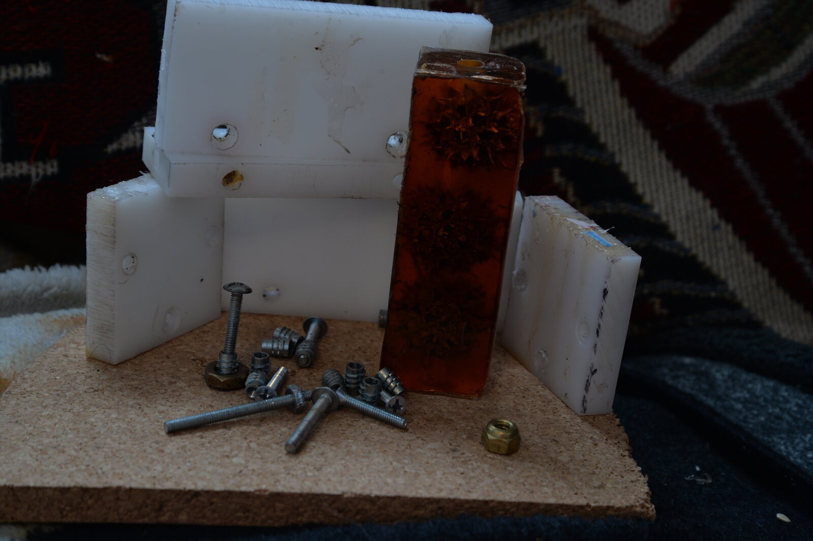

The first one was kind of a failure but it worked I cut up an old inner-tube and used it as a gasket it did stop leaks had trouble with the screws I used countersunk heads
then found some pan head screws they worked way better, I really need help getting the center of the 1/2" let alone clamping and drilling
how do you drill the holes I do use a drill press. this time will first use a drill size of 11/64" much closer to the #8 32 screws that I am using then drill the #1 .2280 bit but how to hold and drill all a 1/2" deep. that blank is with sweet gum balls pre dipped (same setting) then into the mold was with yellow dye but really looks more amber

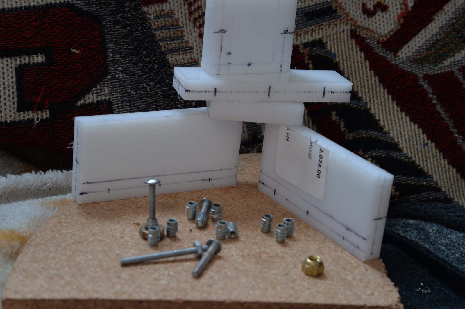

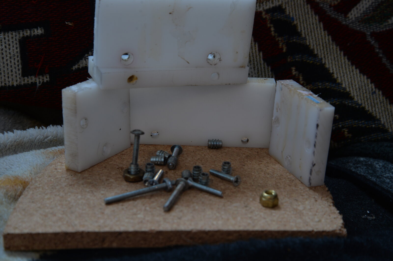

I draw pencil lines along all of my joints so I know where to drill. Then I drill the first piece, line it up along the second piece and push the drill bit in the hole to make a mark where to drill. I then drill the second hole separately to the desired depth on the drill press. I use some silicone caulk in the joints and then put a clamp on them while I place the screws. I like to use pan head screws so they dig in as bad if over tightened and screw them in with a screw driver and not the drill. I don't make a lot of them anymore unless I need a special size but I like to make the top of the mold a little larger opening than the bottom so the blanks come out without having to dismantle the mold.

thanks, so looking at the bottom pic if I drill all three holes in the sides then use the bit to mark all three then repeat for the endcaps
