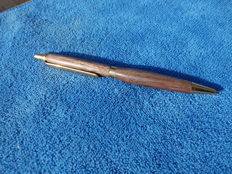

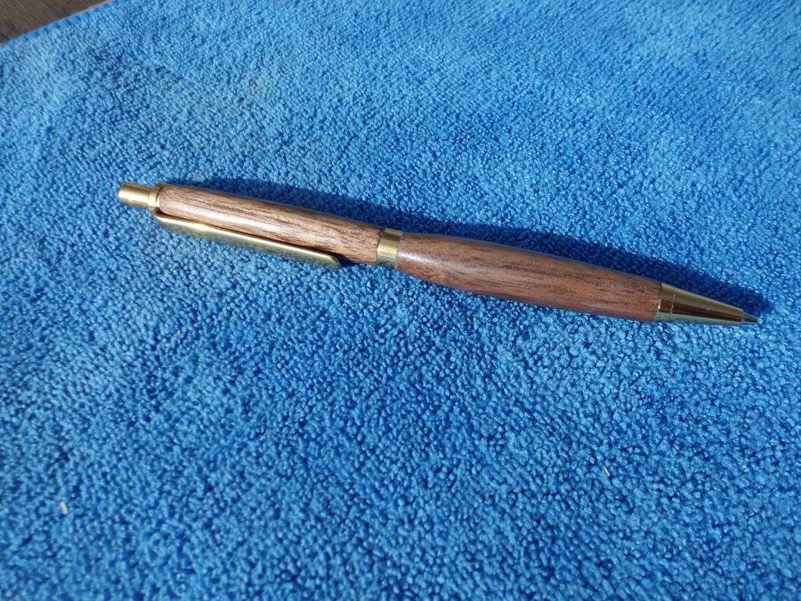

Turned out pretty nice ... just American Walnut with a CA finish.
Wierd ... I know I loaded it, and the link is in plain view when I quote the post, but it's not showing up at all ... lol
Must be because I loaded multiple pictures using a different thread, perhaps?
Lemmie load it again.
attachment.php
