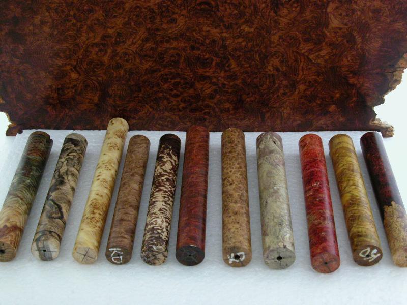

Here's a picture of a few burls and my little amboyna burl slab I recently got. Should give quiet a few blanks:biggrin:
Keith "mrburls"

Rock on Keith, awesome wood as always! :)
Keith "mrburls"

Nice stuff too Kieth, Whats the the 5th one from the left??
Very nice slab, gonna cut into it any time soon?
Blanks are from left to right:
Douglas Fir or Hemlock Burl
Spalted Hackberry
Yellow Cedar Burl
Brown Mallee Burl
Spalted Big Leaf Maple
Amboyna Burl
Teak Burl
Black and White Ebony Burl
Red (not dyed) Box Elder Burl
Chittum Burl
Cocobolo Burl
As for the big block of Amboyna Burl, I may save for awhile. Been cutting up alot of amboyna burl like that lately and stashing away for a rainy day.
Keith "mrburls"
