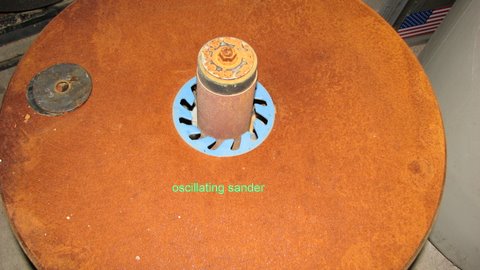

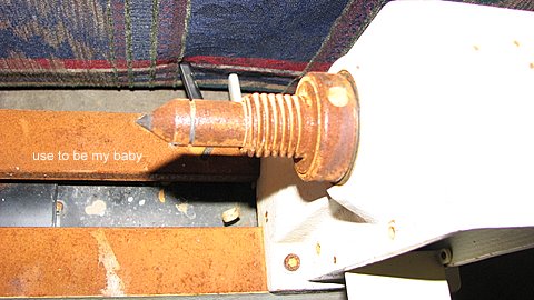

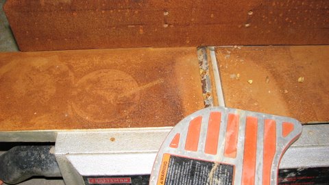

OK, after much thinking on how to resize photos to post here,
I reloaded Picasa on new PC and got going again.
Here are some of my "treasures",heh. Just lovely!
I also have a ton of hand tools,sockets and the like that would be rough to
hand clean each piece,but l think would be easy as pie to soak in the
Evapo-Rust.I will be trying some of that.:biggrin:
