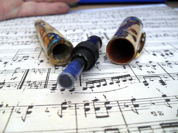

very thin - this one is a wormwood Mutt blank with a RP sleave
timber OD is 14.7mm heading to 16mm this has a 14.2mm hole drilled into it to take the RP sleave - This intern is drilled 13mm (half way) and 12.5mm the reminder
The PR sleave is tapped using a M14x0.8mm tripple start thread
Curtainly wouldn't work it from the outside to the inside as discribed above
