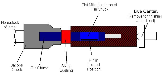

OK let me see if I understand what a pin chuck is. A rod the diameter of the particular tube of the pen you are working with. This rod has a flat milled in it. The depth of this flat when combined with the diameter of a small nail equals the diameter of the rod. The small nail is placed on the flat and the pen tube is inserted over the rod and nail. Turning the tube causes the nail to roll on the flat and wedges inside the tube, effectively holding it in place so it can be turned. Correct? What is the bushing you speak of for?
Jim,
The bushing is what you turn the end of the pen down to. Just like when you turn a Baron or a Gent. The only difference is that the hole is drilled out to slide over the rod that the pin chuck is made from.
So a Baron bushing which is around .488 or so +- has a hole in the center for the 7mm mandrel. The bushings I make for the Pin Chucks have a 23/64" hole in the center to mate with the inner diamter of the 10mm tube. The Gents woould be around 27/64" or whatever the proper size is. (Still have to look intot hat one). Hope that helps.
Fangar
Fangar

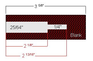

Here is a quick example I drew up for the Baron. Me like Pictures... Pictures GOOD!
