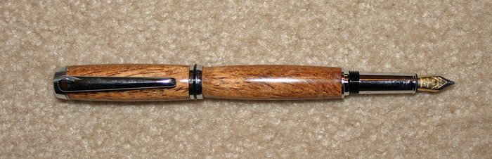

Most Berea couplers are four-start and most CS USA couplers are three start. Orientation of the nib and clip such that the clip is in a comfortable position for writing is critical to the comfort of using the pen. In the example below you will see that the clip is on the same plane as the face of the nib. This insures that the clip will not ride against the thumb or index finger of either a left-handed or write-handed writer.
On a Baron, for example, if you do not test fit the couplers, you may be off as much as 45-degrees from the desired writing position. On a Jr. Statesman, you may be off as much as 60-degrees. That much difference causes an imbalance which detracts from the writing pleasure.
