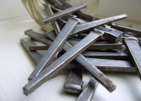

Yeah, come to think of it, a cut nail would be perfect for this project.
I have a big box here if you can't find some locally.

Masonry nail.

Cut nails are case hardened too. A flat nail would be perfect for making such a tool.
A little work on a grinder to get the right profile & you're all set.
If I understand the application, my thought is that you could grind the head in a way to create a single tooth 90 degrees to the shaft of the mail. Then the nail glued into a handle.
