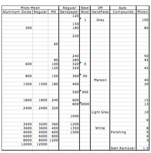

I've attached a jpg that shows a spread sheet of the various sanding grits of different things. I hope it helps.
GK
