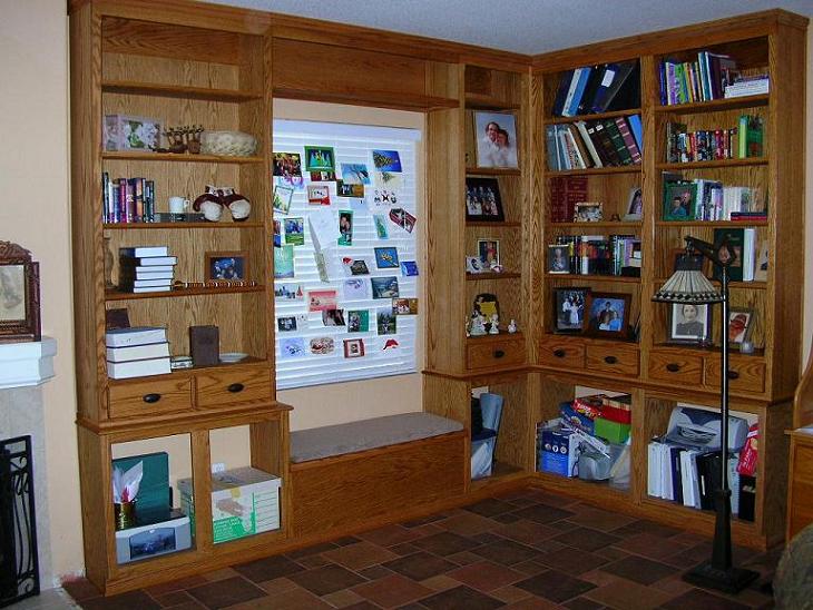

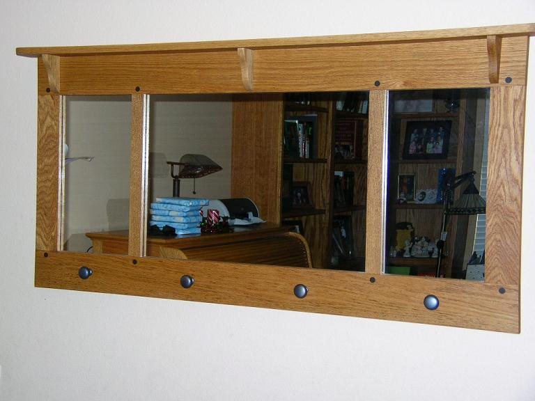

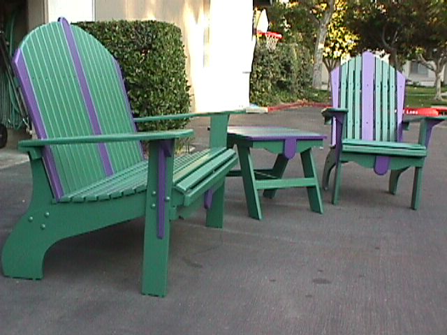

Yup. Your on the money with those comments. I look at things from the creator point of view as opposed to the consumer point of view. Since I am looking at doing pen turning with a view to sell some them, I have to look at things a bit differently. Apart from the pens, everything else that I do and have done over the years, both for personal use as well as for others as gifts and clients, is more furniture type applications for indoor and outdoor use which deals with a different type of finishing. Such as these bookcases that I have been working on in my home for the past two years (all done except for building the doors for the base cabinets), this mirror and Adirondack furniture which I have sold a number of pieces of.
