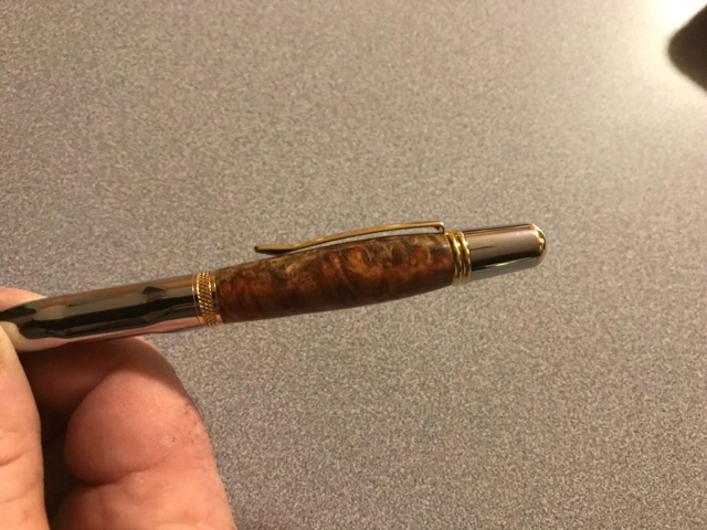

Here is the one I made after work tonight. Now to relax and have some dinner.
A Sierra grip with cherry burl.
